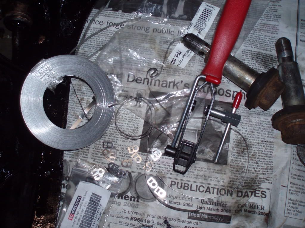

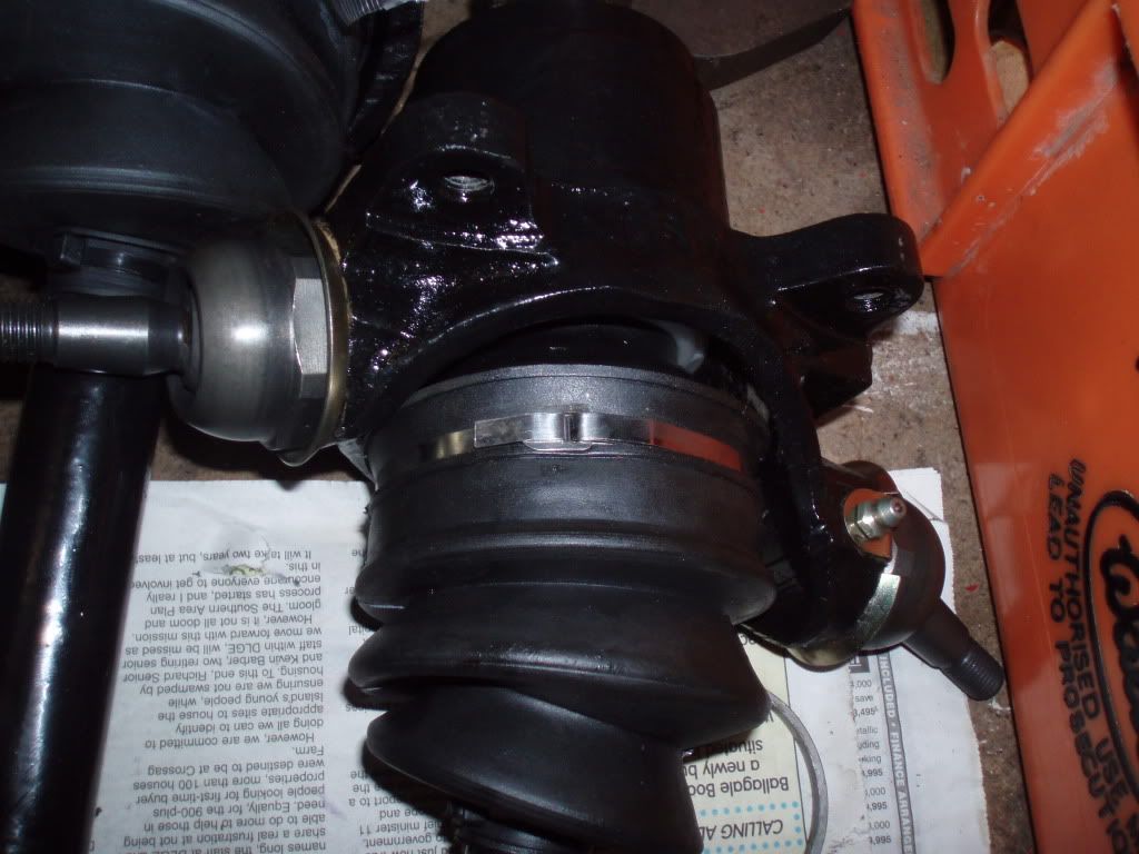

I bought one of these sets and like a spaz i cannot figure out how to work it.
Can you help?
On 30th May, 2009 joeybaby83 said:
they are brilliant neil
I the kit from this guy:
http://cgi.ebay.co.uk/CV-Drive-Shaft-Boot-...%3A1%7C294%3A50
would definately recommend it
yarp, took me a while to figure
there should be a clip with a hole and a slot
from memory (always a bad start) you fold one end through the slot over the hole, wrap the band round once or twice or three times if youre me, always tucking the end through the slot, then once your happy, cut leaving 4 inches or so sticking through the slot, feed this through the tool, tighten it up, then fold over against the slot to retain tension, and use the bit in the tip to cut off the excess
i might have it wrong, but it works
Also, keep in mind the direction the cv is rotating to you fold it the right way, otherwise it might catch plastic bags and stuff and wrap it around your cv :)
better late than never (just stumble acrss these pics and remembered i was meant to post them lol)
