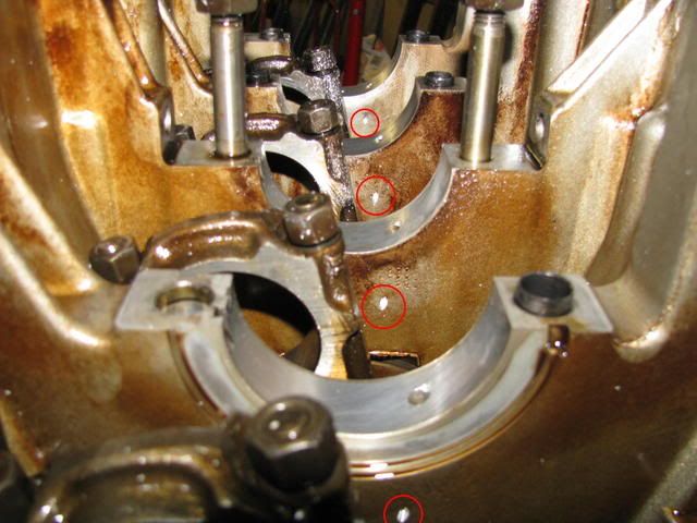

The engine was fully rebuilt, with undercrown oil jets á la Rizzardini, and cylinder head fettled by the world famous BENROSS. Turbo is a T25 as it has a peculiar flange arrangement specific to the Peugeot manifold. However looking at the compressor map its good for about 18 psi on the 1600 engine.

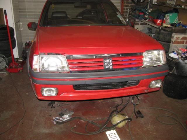

Thanks also must go to my mate Phil of brackets fame who modified a Cosworth intercooler for me to squeeze in behind the bumper, and also made me a bracket to support the rad further back.

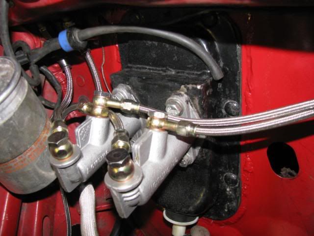

Although the initial plan was just to turbo the engine, I got a bit carried away modifying the rest of the car, including negative camber front arms, plate LSD, 266mm front brakes, bias pedal box, rear vented discs, and a wide track rear beam with +4mm uprated torsion bars.

Can I just ask what I have to do with the under crown jets?

Cheers chaps. Recirc dump valve is just to keep it nice and discreet, I put a bit of effort into making sure everything was hidden under the front end, and also cut the tailpipe off a stainless magnex exhaust system to "kind of" copy the tailpipe of the standard system, so it would be no good having a noisy dump valve giving the game away to all the chavs!
Front end without no plate fitted, but if you look hard you can just make out the intercooler.

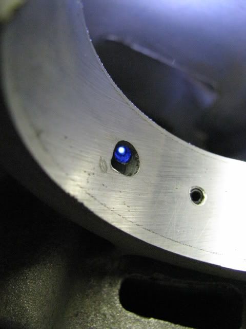

Nic, I'm sure I got the idea for the oil jets from you, drillings through the block webs, tapped, then fitted with grub screws with a 1.0mm hole drilled in them.
See pics-
and
