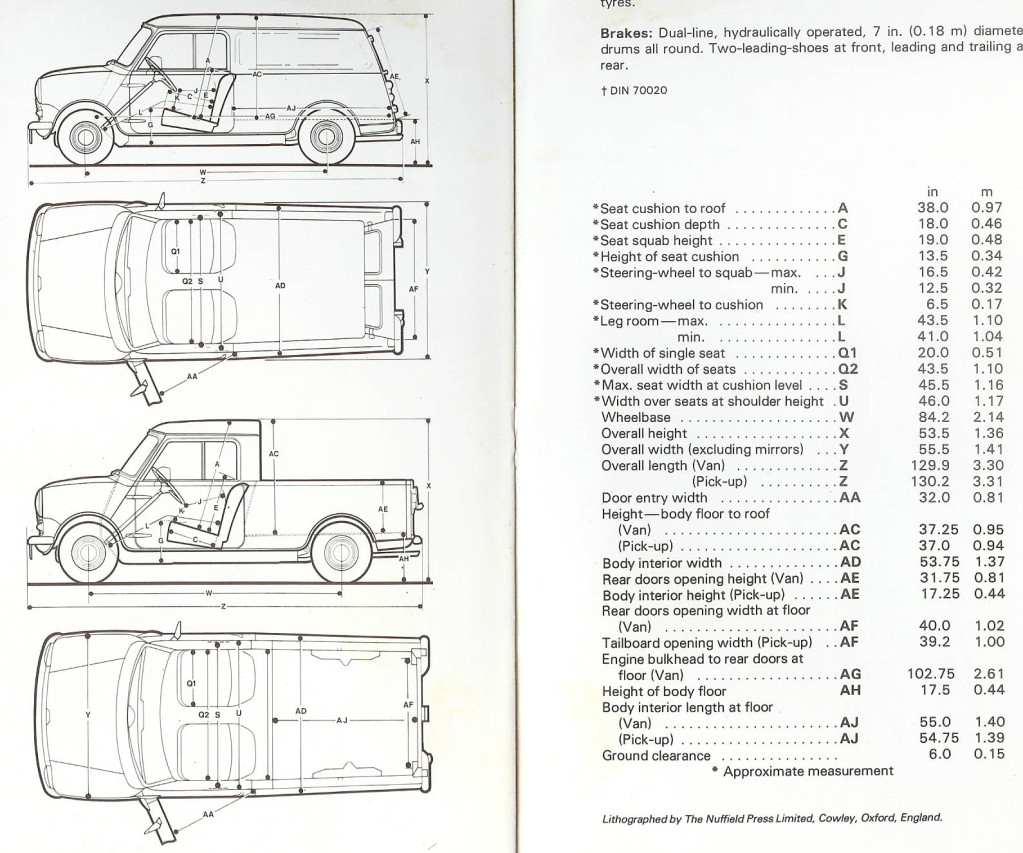

Hi dave, ive got this picture with some dimensions on if it helps.
That's usefull - gives me a nice plan view of the load bed.
