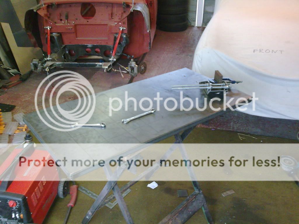

Pic before I got the stainless surfaces ( they were expensive ), just bought an 8x4 sheet of 1.5mm and cut it to size, and kept the rest fo spare.
9.85 @ 145mph
202mph standing mile
Here's where I'm at so far:
5mm with a 25mm box lattice underneath.
That looks like a work mate to me...
