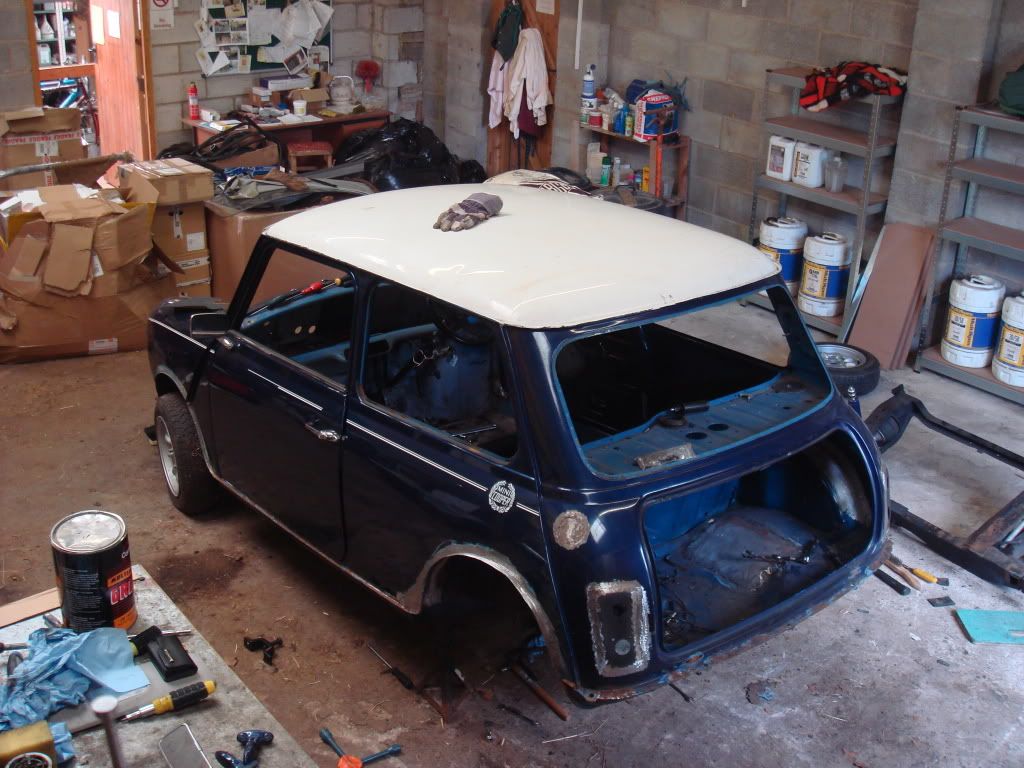

so, to introduce myself, i'm Alistair, 19 and am at loughborough university studying auotomotive engineering.
as soon as i get home for summer i'm going to be getting stuck in with my mini project.
a picture of how it currently stands:
except the front subframe is now removed.
i am hoping to compete with it in the future, most probably hillclimb.
any help and advice along the way would be much appreciated.
cheers.

The more of us hillclimbing the better. Can I direct you here www.hillclimbandcprint.co.uk a great national club for begginers and seasoned racers.
Looks like a good starting point with the shell.
lookd like a solid shell, good luck with your build
