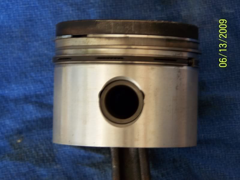

one of the best looking pistons squirt and ringland, with shiny rings, had been run it , like this:
basic mineral oil up to track 200 km,motorbike oil change just before start racing, then go on all the week end, with the only the saturday limited to 3/4 full rev!

go on, what's it look like after:
