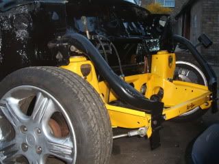

Hadsome made for mine out of 2mm 2"dia tube with gusset plates. Stiff as!
It still amazes me that the only ones available are those shit square section bits of turd.

MIne bolt onto the side of the cross member under the top mount bracket and curve round and bolt onto the tear drop mount bolt hole.

I was getting the most amount of flex and subframe movement with the standard items avaiable off the shelf.

The minispares/sport one s are a good solution if you run a side rad. If not there are better solutions as shown above.

I use the Mini speed side mounted ally rad which is much deeper than the 4 core I originaly had fitted, so they work with side rads too.

What size tube Mr Joshua ???
I was thinking of 38mm (1 1/2"), 2mm wall but I see you have additional gusset plates in the bottom curve.
