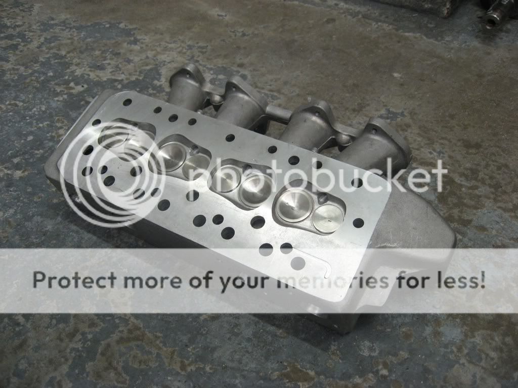

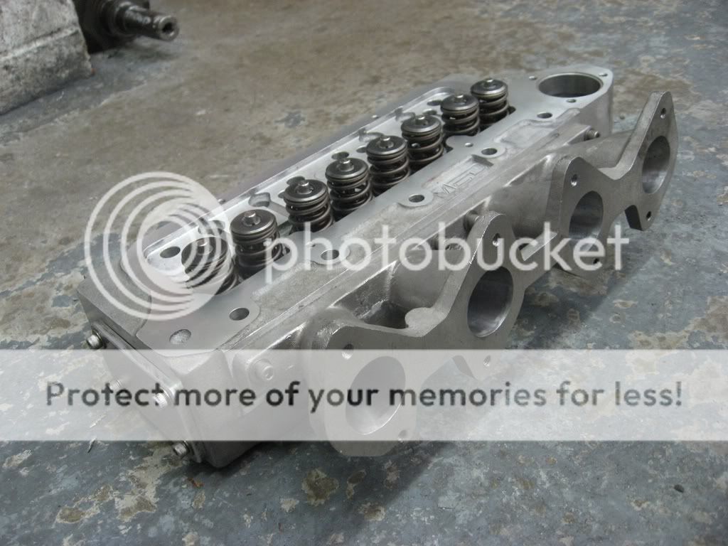

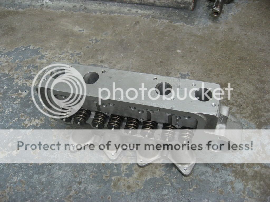

the above dosn't make any sence to me,
[img]http://i553.photobucket.com/albums/jj367/preston-pill/IMG_2479.jpg[img/]
[img]http://i553.photobucket.com/albums/jj367/preston-pill/head.jpg[img/]
[img]http://i553.photobucket.com/albums/jj367/preston-pill/IMG_2475.jpg[img/]

Sorry Carl.
I was reffering to mini_surfari when he mentioned the MED 8 port that could be bolted straight on.
My mate bought one of the 'bolt on 8 port' prototypes (which has turned into being not quite 'bolt on').
MED said that the reason they decided to ditch the 8 port idea was because the alloy 7 port they are producing wasn't far behind it performance wise and the extra outlay for other bits like an expensive manifold made it not worth selling it (this is what I was told) as the 7-port uses a standard manifold.
tomkidd
478 Posts
Member #: 1962
Lancaster
p.s. The MED 8-port above isn't a true 8-port and is VERY similar to the Elder 8-port from Oz.
