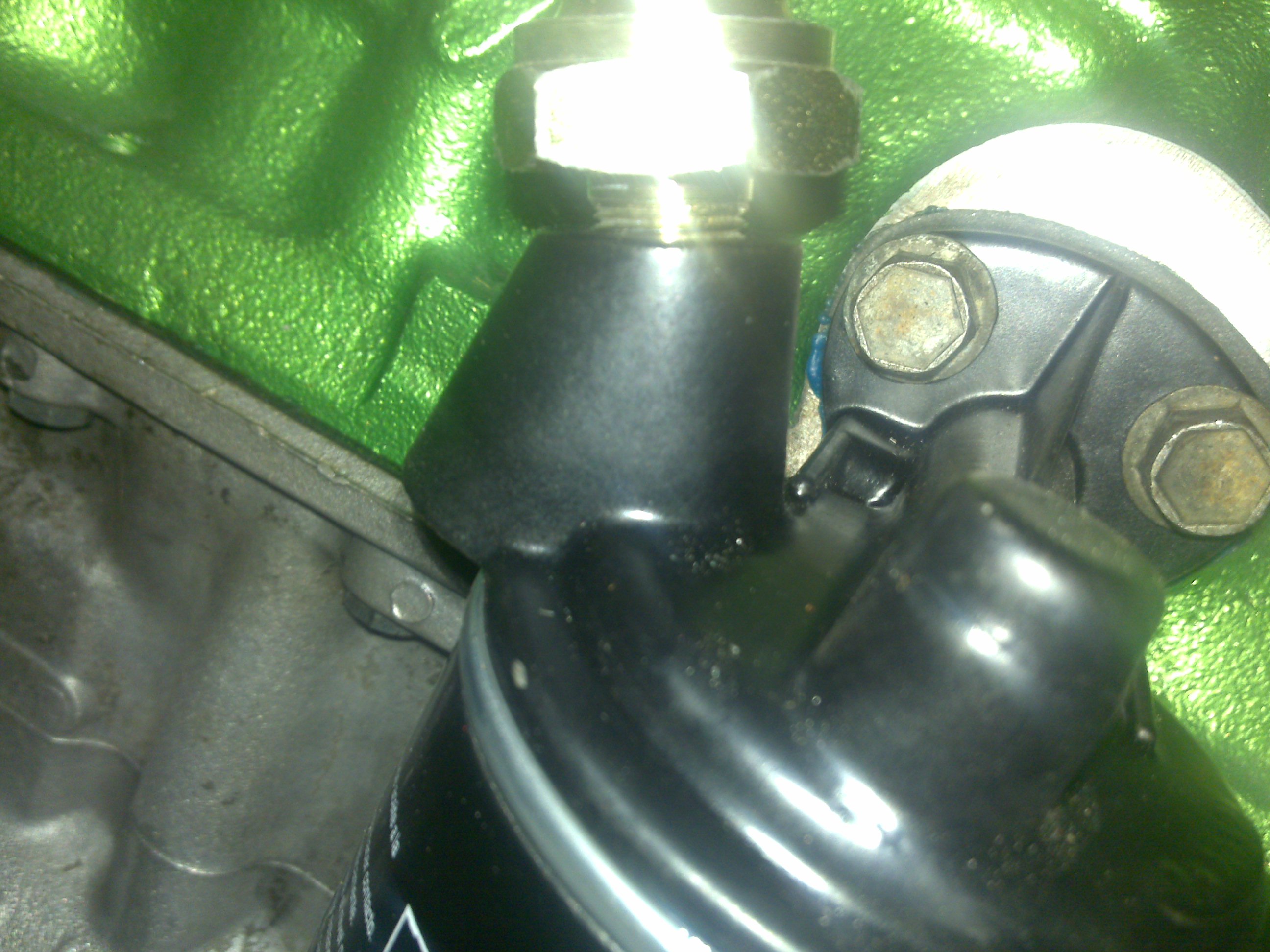

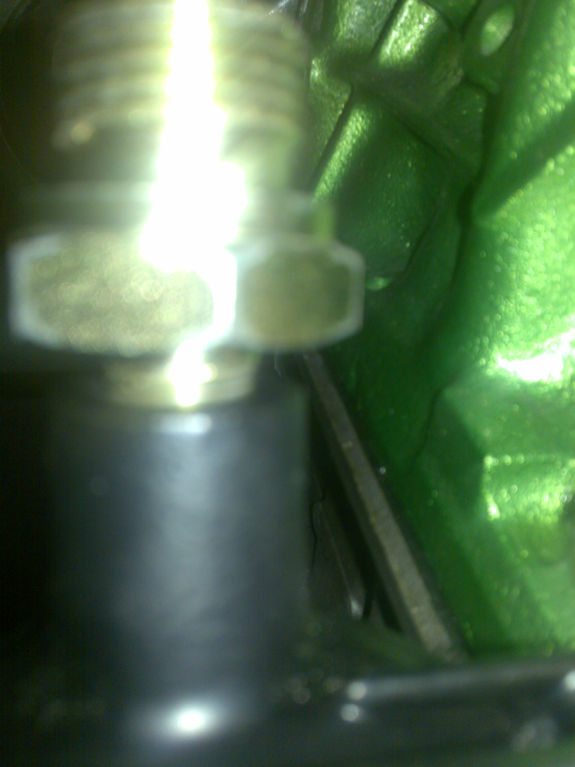

I am trying to fit my new oil cooler and i am having problems with the attachment connecting to the oil filter housing. The cooler section does not want to screw right in and goes reali tight! is this as far as its ment to go or am i doing some thing wrong! please help... |

is it not a tapered thread on that fitting?!

pass? the other section that goes into the block goes all the way so i dont understand why they would put thread all the way on the other connecter and it not go in all the way in?. |

Its not an SPI filter head is it? They use different threads IIRC.

As iain says, the bit going into the housing is a tapered thread, so it will just go tight. I would gather the other side just being 1/2 bsp so that will go all the way in.

its just a standard filter head, i guess thats as far as it goes then thanks for the help and its a flake green.. |

its just a standard filter head, i guess thats as far as it goes then thanks for the help and its a flake green.. As said above and to clarify you shoud have two male to male unions (thread on the outside) the union where both of these are parrallel fits into the block with a copper sealing washer. the other union will have one parrallel thread and one tappered thread, the tappered thread screws into the filter housing no washer required. Be sure not to over do it as you can crack the houwsing. Own the day

great think i have it right then thanks! |
