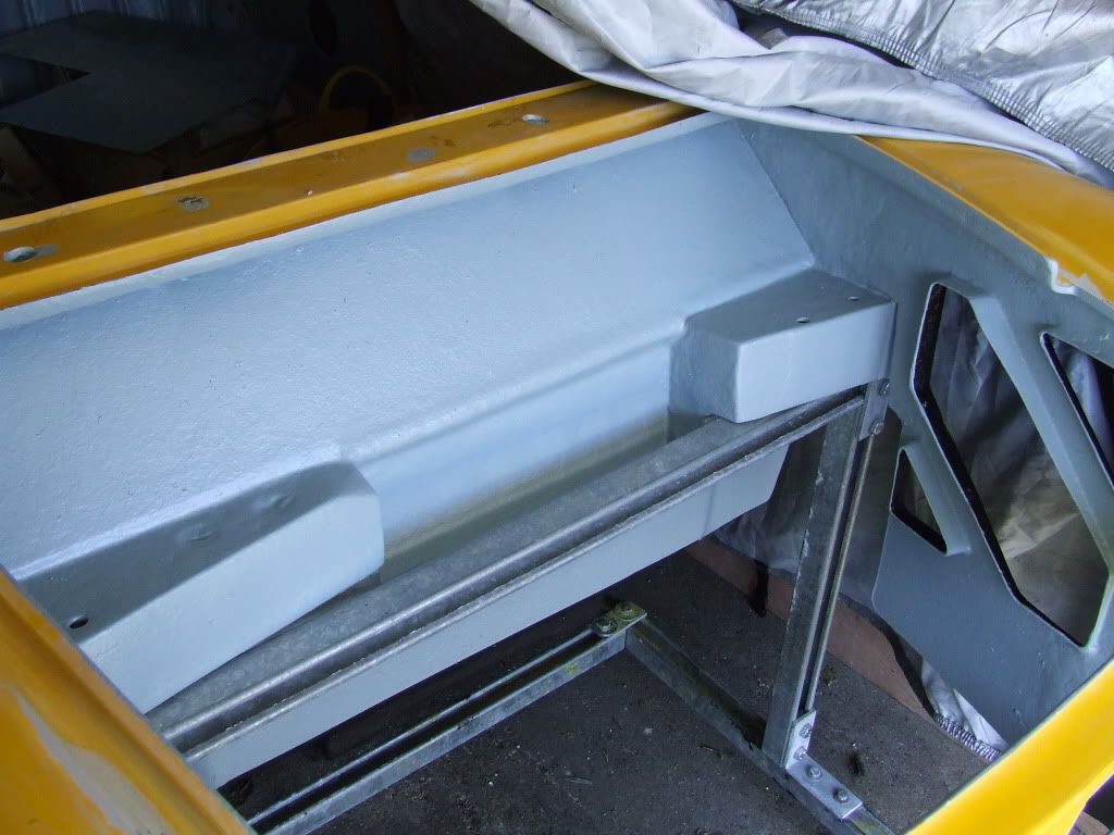

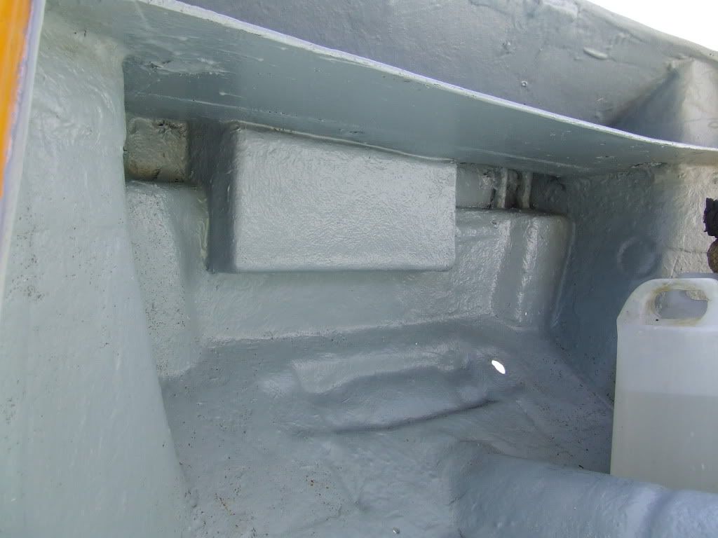

Have a read / look thru the build thread on my minus. I layed up a bulkhead box and fitted it, was simple enough to do.
Shane
http://www.turbominis.co.uk/forums//index....p=vt&tid=168459

shane
2643 Posts
Member #: 1246
Lowestoft, Suffolk.
Just to add a few pics.

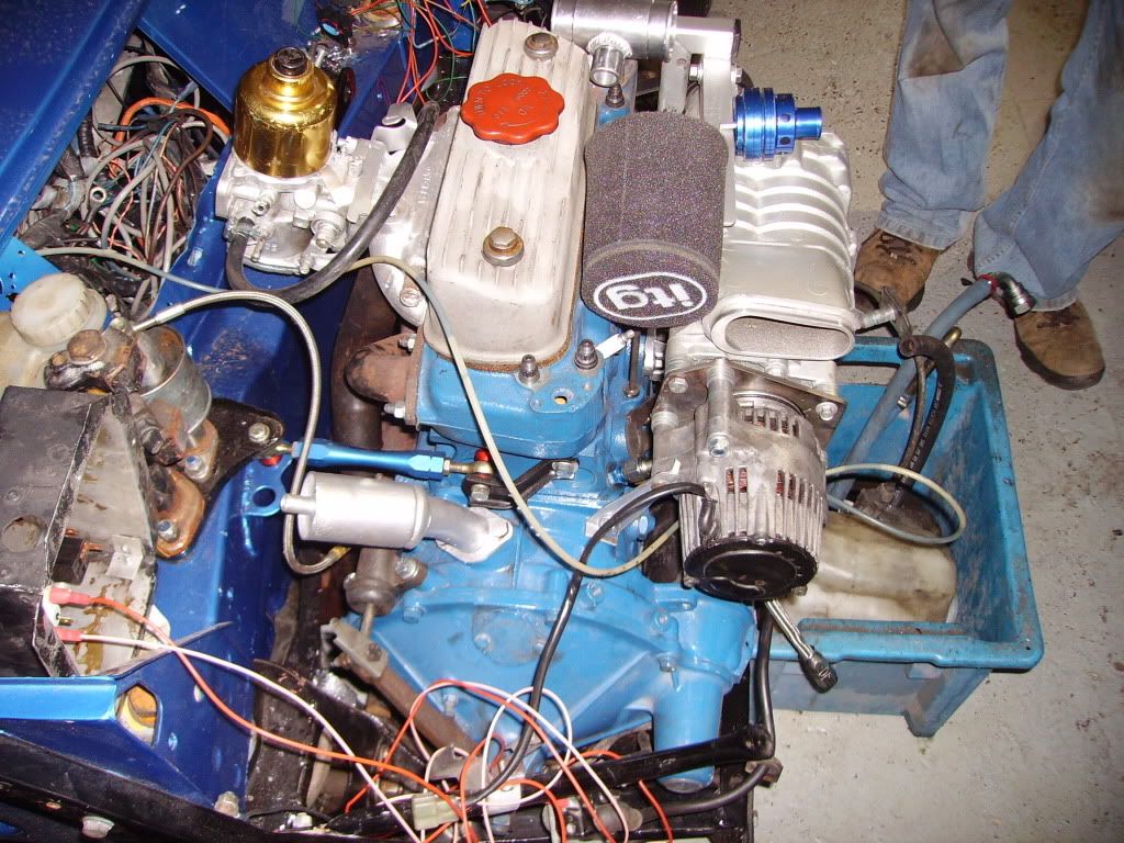

Think I've found the answer!!!
I had my MPi on the rollers at Slark Race Engineering yesterday, and I saw this in the back of the garage:
I like...
