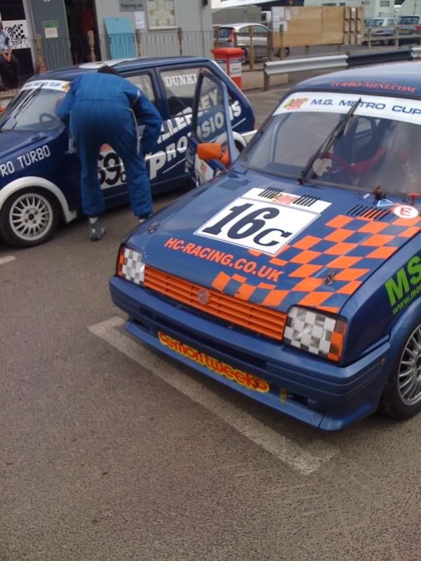

here are a few pictures sorry they are only off my iphone so not great.
well done to jim from team tenatious turbo for the win aswell!

My driveshaft popped 9 laps into an 18 lap race when I was in 2nd place but gaining on first. It was puzzling as I should be able to drive with 1 driveshaft with a plate LSD but I had no drive.
Thanks to a donation of a drive shaft and some help from Andy we replaced the shaft, Eagle eyes Andy noticed a small crack where the droop stop sits so we had to to scab a welder to!..
We got ready on day 2 for race 2 and I lost drive on the way to the pit lane, Jimster was nearby and noticed my probs and Andy, Jimbo and others pushed to The Mark wanstall's, Endaf and Jimster garage where the shaft was removed, checked over and refitted in minutes but then went again as I pulled away for the last few mins of qualifying it went again!..FOOK!
Andy, James and others scrambled to find another shaft, inner CV and circlips then we removed the shaft again triple checked it, test drove it around the paddock then begged the clerk of the course to let me out to qualify with another formula(this often happens in friendy club racing), he said "just start at the rear of the grid" That was fine for me as that was where I would start anyway.
Race 2, so back of the grid I got a poor start with bogging down slighty but once the Turbo came on song I got past lots of the slower cars, they just seemed to clear the way for me!... I must have ended up in 5th/6th by the "Devil's Elbow" but as I changed from 3rd to 2nd I heard an almighty griding noise and no drive again!... so another DNF.
I got home from Lydden at 7pm, had the engine out by 9pm and in the pub by 9.30pm!
I dropped into Morspeed today and we stripped the box to find the selector rod that is 2 pieces pressed together had come loose, this would make it seem in gear but not be but be intermittent.
So we had 2 problems, one of which was not very obvious!
Gutted as my championship lead is long gone but I will be out at Silverstone hoping to make up lost points.
We had a good piss up and BBQ with the Mini crowd. Bill Richards was awasome, doing 2 races one after the other, winning both, literally 5 mins between the 2 races, new tyres, fuel and back out. That throttle body 16v Kad realy sings!
Shame about Jimbo's car but 10 out of 10 for effort. Respect.
Thanks to James and Andy for your help!
JF. *smiley*
