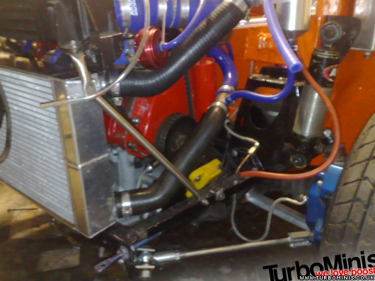

Heres a pic of the side of my Rad
Heres a pic of the pulley
Wil how can i test the flow? Take the Hose off the rad whilst running lol?
BTW in the top pic, the top black hose goes into the thermo housing.
and the bottom goes to the water pump. You can also see the feed to the header tank.
