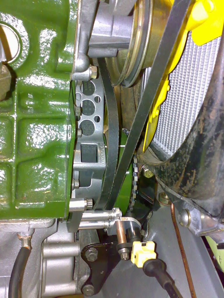

This is the SC Components bracket with a Ford sensor and 36/1 wheel on my van.
But there are plenty of DIY ways of making up a bracket. Just need to do a search.

The SC bracket is for a sensor on the back of the crank though, isn't it? That's where the MED trigger is, which is the kit I think I'm going to use...
