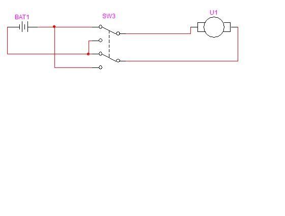

IIRC, its just a simple 2 wire motor that you wire each way to change direction.
You should be able to rig it up to a multipole switch to get the desired effect I think.

The only thing not shown there is a "dead" position on the switch so that its not permantly powered.
Hope that makes sense.

t2clubby, cheers, your a star!! been playing with it earlier, seems like it will work..... little spot weld and little bit of wiring and job will be a good un for the back door.

am i right in thinking an electric window switch would work like this? just that a got a few of them kicking around, so could save a few quid....

yip :)

Window switch would be perfect!
