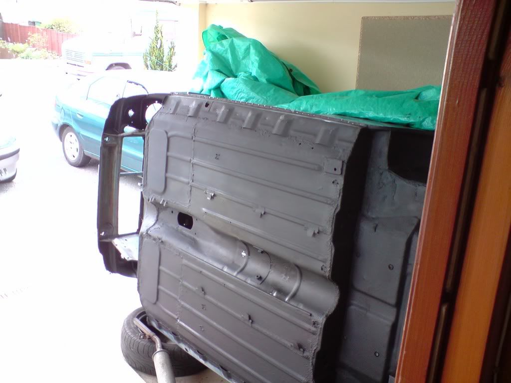

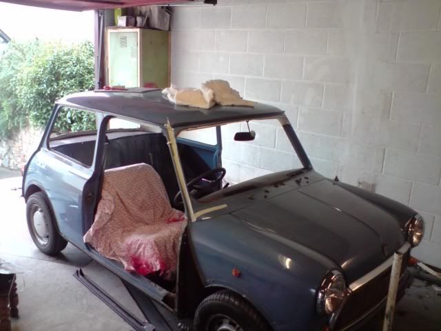

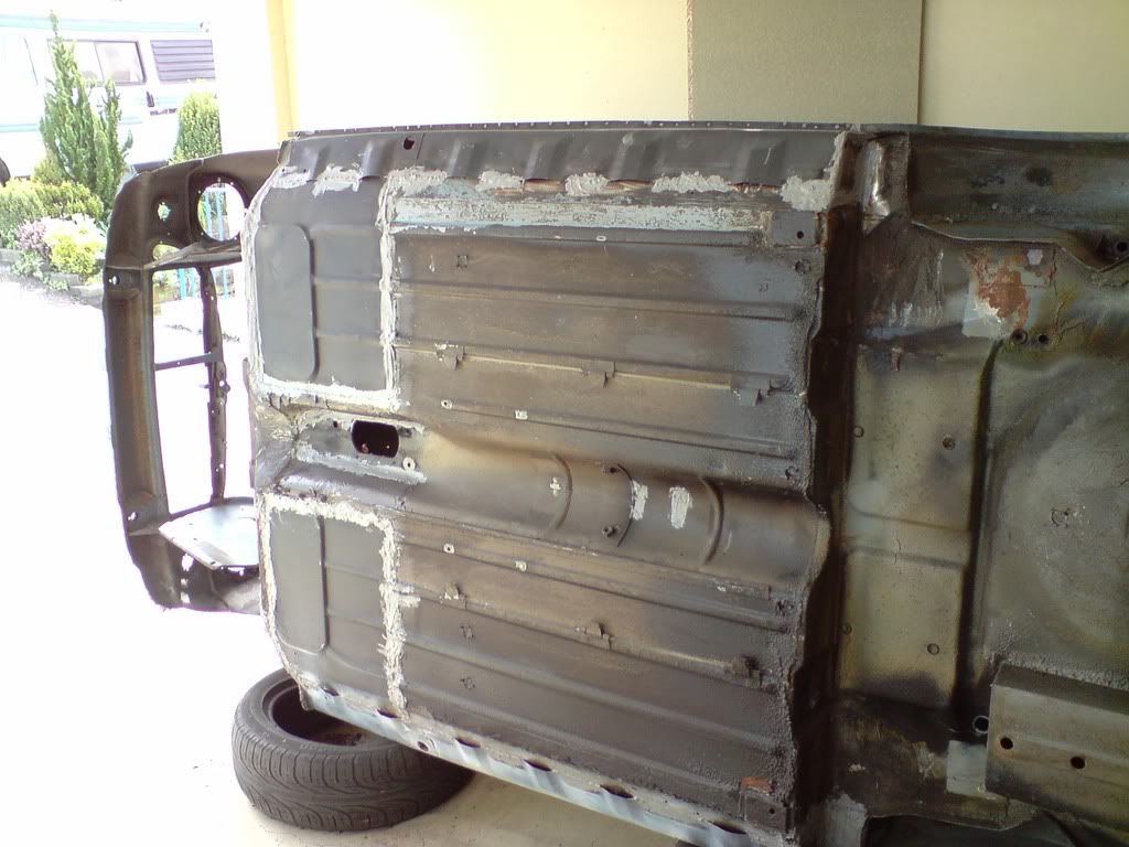

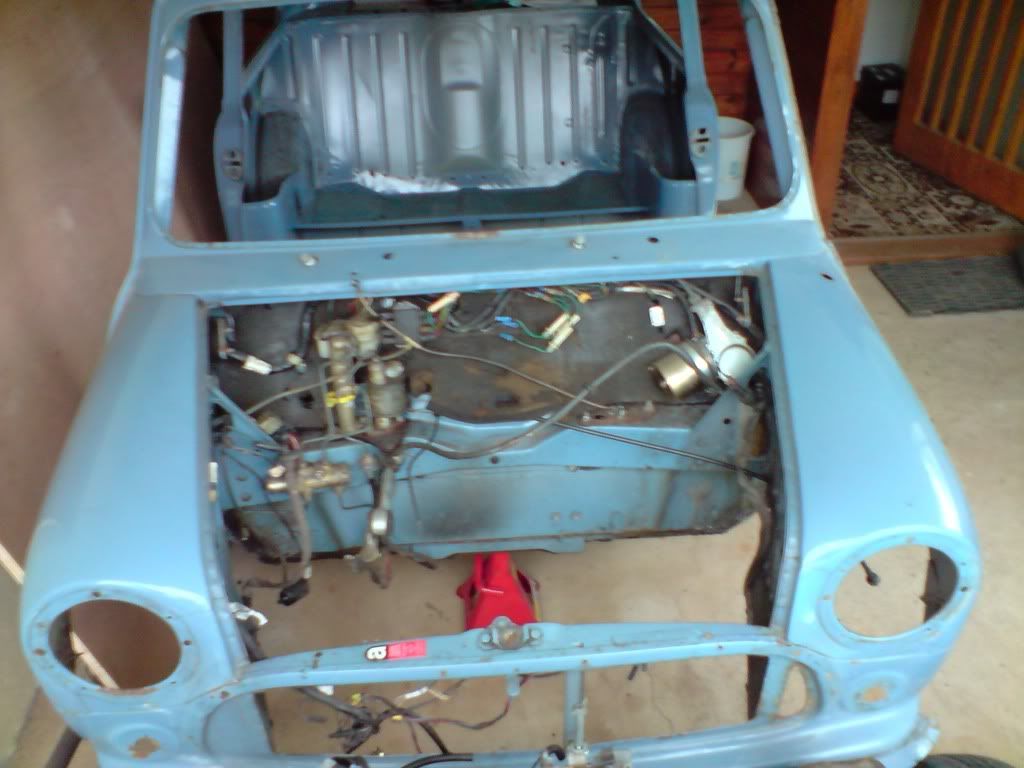

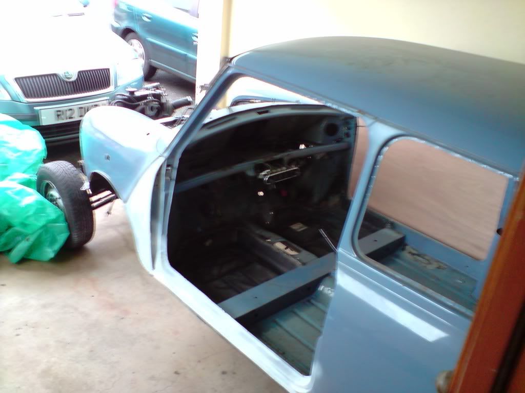

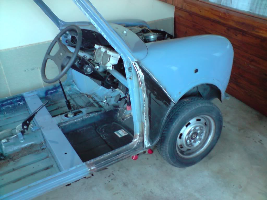

After being on here a while and getting the most helpful information I wanted to do alittle write up on my mini from start to where it is now, and then hopefully what is in stall for it in the next 12 months.
I bought it from Tupmans Minis in Feb 2008 as a bog standard 29000 miler with all MOT's and paperwork.
It was going to be a rolling project but i got carried away and stripped it so heres some pictures.
Thats pretty much how it looks at the moment any way. Running 80 bhp at the flywheel, bit down on power but teh next jobs are:
New cam timing gear and ensure the cam is timed in properly.
Head work, needs to be stage 3/4, not 2 as is at present.
New lcb manifold as i have a freeflow on at present.

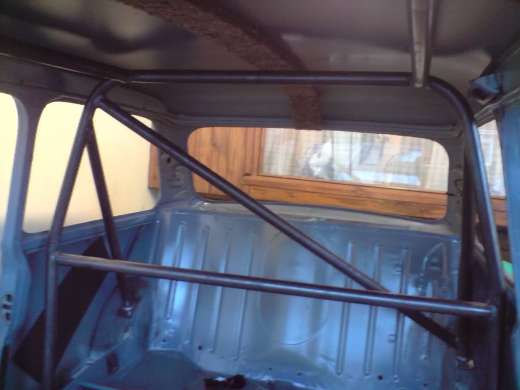

And the biggest mistake of all during the 18 months - cutting the headlining before putting the roll cage in!
Let me know your opinions.
JOn
