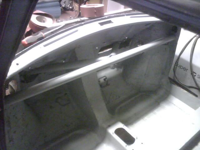

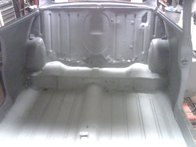

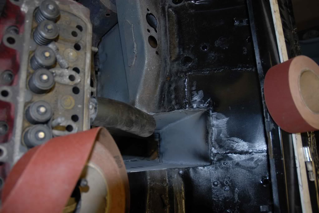

Well here is some pic of the shell to date
Anyone guess what’s going on with this little mod?

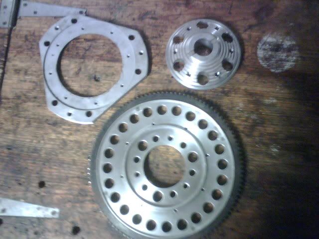

Here is some pic of the flywheel I have come up with,

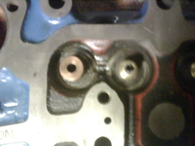

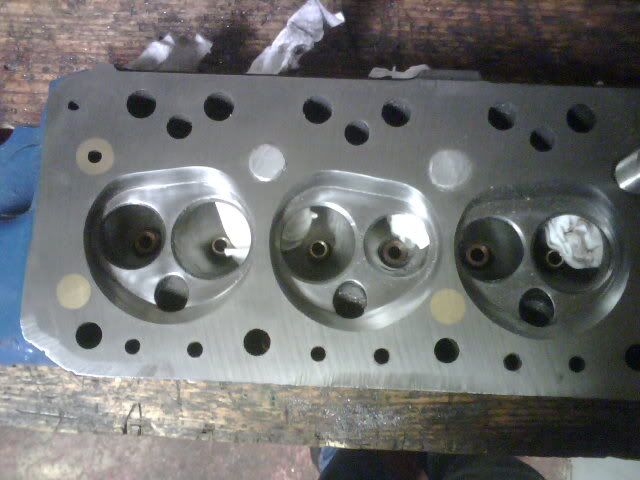

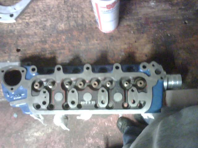

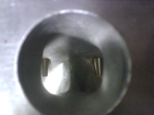

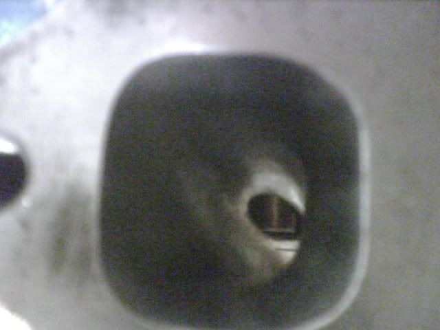

Here is the cylinder head Turbo Phil has given me a great hand with this doing all the, Porting,Chamber work as well as making custom 6mm valve guides and offseting the Exhaust guides. I have done the dry deck work as well as some trick CNC valve seat machining pic of that I'm afraid are on there way

whats going on with the exhmanifold?
i recognise that flywheel setup.

Joe the Exhaust is something I worked out on Dynomation, In order to make the best out of the cam and cylinder head setup I found I had to have some weird primarys the only way to fit them in, was to creat what I can only describe as a weber box for the Exhaust.
