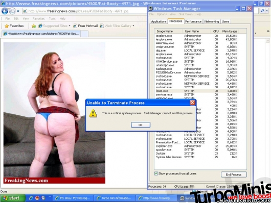

well all was going great, deleted loads of the fuckers, but now have 2 that i think might be a problem?
csrss.exe
lsass.exe
like below:
but, when i try to close them down i get this:
so what do you guys think I should do? Norton isnt picking them up, and neither is ad-aware or search and destroy?

lsass and csrss are both system critical processes. Thankfully windows stops you from ending them, as if you could end them, you would be picking up the pieces for some time!
Also, just ending processes does very little to help rid your computer of shite. They'l all be back again when you next restart your computer. You have to find what programs set these processes running that you dont want to run, so that they will no longer be generated. But of course, make sure you look in to what you are removing and where before going ahead, or you could be re-installing your operating system before long.

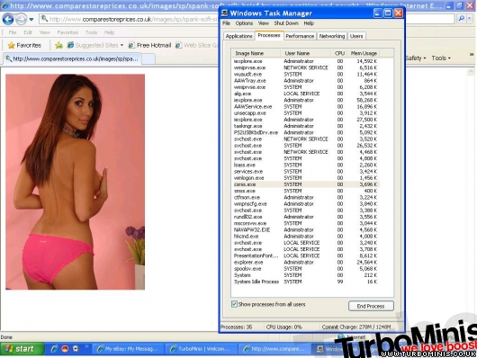

Look into these a bit deeper:
C:WINDOWSSystem32svchost.exe
C:WINDOWSsystem32rundll32.exe
http://kc.bar.need2find.com/KC/menusearch.html?p=KC
Personally Im quite partial to picture 1. Picture 2 has a fat arse. Not my bag!

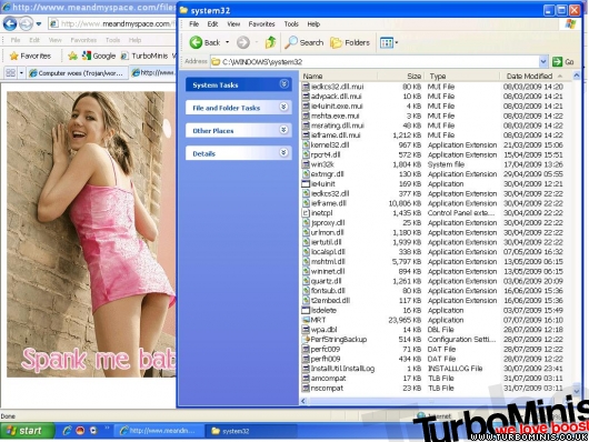

Check system32 folder in windows folder for recent installed files..especially *.dll files. Prefetch is also often used (so to allow reinfection) on a system restore. 'Hidden' (attrib -h) attribute is also used to hide files.

Ive gone into that folder manifold, and sorted by date modified:
and this is whats down at the bottom?
Some of them have perf*** prefixes which may have nothing to do with what you were saying but then again...?
ive never meddled this indepth before, if i delete the wrong things in here, will it break my pc?
oh, and how do i find those hidden files?

...on the files do a sort on the top heading 'date modified' look at newest dates first. be careful what you delete lol
....or you will be doing a rebuild anyway!

Sorry Joe, deleting the wrong system32 files is often a mine field as well. I cant remember the important files off hand but about 95% are needed I think, all with wierd and wonderful names.
