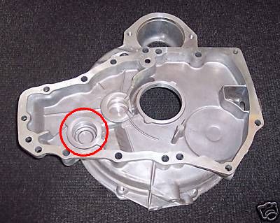

i need to order a bearing but i dont know what its called, im sure minispares has them.
i understand they come in 2 different sizes too so how do i know which one i need?

is yours an original turbo box? theyre slightly bigger then the na one
also, how did you get it so clean you sod? mine all look like theyre been excavated out of the dover cliffs
4642 Posts
1st motion shaft nose bearing, & yes the Turbo one is bigger than the normal one. So you need to order a Turbo, or standard one depending which housing you have.

cheers chaps, i believe i need the smaller size.
that cover isnt mine, robbed the image off ebay *wink* although my cover is just as clean, a good sloshing or liquid (not spray) gunk and a wire brush on the end of a dremel, comes up a treat

i can only seem to find one size :S
i think this is the larger one
http://minispares.com/Product.aspx?ty=pb&pid=34555
http://turbominis.co.uk/forums/index.php?p=vt&tid=170151
The turbo type is approx 43mm OD. The standard type is smaller. This should help you identify your casing.
thats the small one,
this is the larger turbo one,
http://minispares.com/Product.aspx?ty=pb&pid=32830
The price is the giveaway as to which is which...
