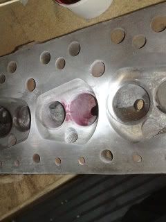

Not that I neglected to inspect the head before I started the porting and shaping, but part way through the stone grinding phase I noticed the dust tracking in an all to familiar way on the adjacent chamber. It was obvious what I was seeing so I finished the head seeing as I only had two chambers left to do to complete the job then did a crack test.
This is what was found
And this
The question is what to do next. There are three distinct approaches to this.
1. Cold stich the crack
2. Cut out the crack and get it welded
3. Remove the crack with new valve seat inserts.
Now three is the less likely option as I dont know how tall an insert you are limited to. Welding I could do myself with the aid of several blow torches. Stiching is a bit of a black art and a new process to me.
What are the thoughts of those in the know?
Edit: if larger pictures will help can be done

ive succesfully welded crack in that area,,
as you suggest, grind a prep , get it almost glowing hot with the bottles and stick weld with dissimilar rods.
theres no reason why it cannot be salvaged.
Yes i've had a cracked head welded there and if done right it can last.

What size valves where in this head when you started ?

the other thing you could do mate is have 8 harden seats fitted.
One thing to remember. If you weld the crack, then have it machined for inserts. This WILL be a total bitch, as the weld is so much harder than the adjacent iron.
I'd bin it without a doubt, and believe me, I've been in the same situation several times.

This was an unmodified MG metro head 35.6mm inlets and 29.2 exhausts.
I hear what your saying Vegard but I have 3 of 6 heads cracked, as is the realisation these heads are becoming hard to come by so a solution to this type of failure is needed before too many more are consigned to the skip.
I am also lending towards cold stitching as Beachgrove engineering has done this successfully on some historic racing car engines and later model Fords (cortina's).
