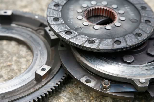

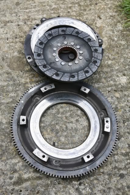

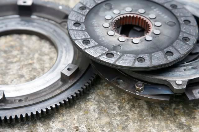

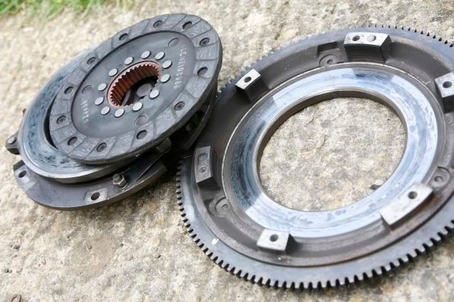

so iv finally managed to get the clutch to slip ..
this was on 15 psi boost at avon ,fast change from 3rd to 4th .and i think generally ,a bit of slippage was taking place ,, it didnt seem to kick on each gearchange .the engine is a bit more powerfull due to it being run a bit richer ,around 13.3 to 1 afr ,still too lean but now hitting 106 mph ish terminal , using the clutch formula ,this equates to 186 lb /ft holding power ,so more torque than that then ,and equating the top speed in the terminal to bhp for vehicle weight , id say over 200 bhp ....now for a bit of a change in friction and pressure.
here are some pictures of the barbecue ..
the plate was actually carbon on the inner edge ..

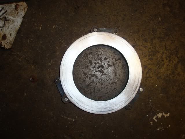

and heres the result ..
so two different springs ,and a higher coeff to try next .
