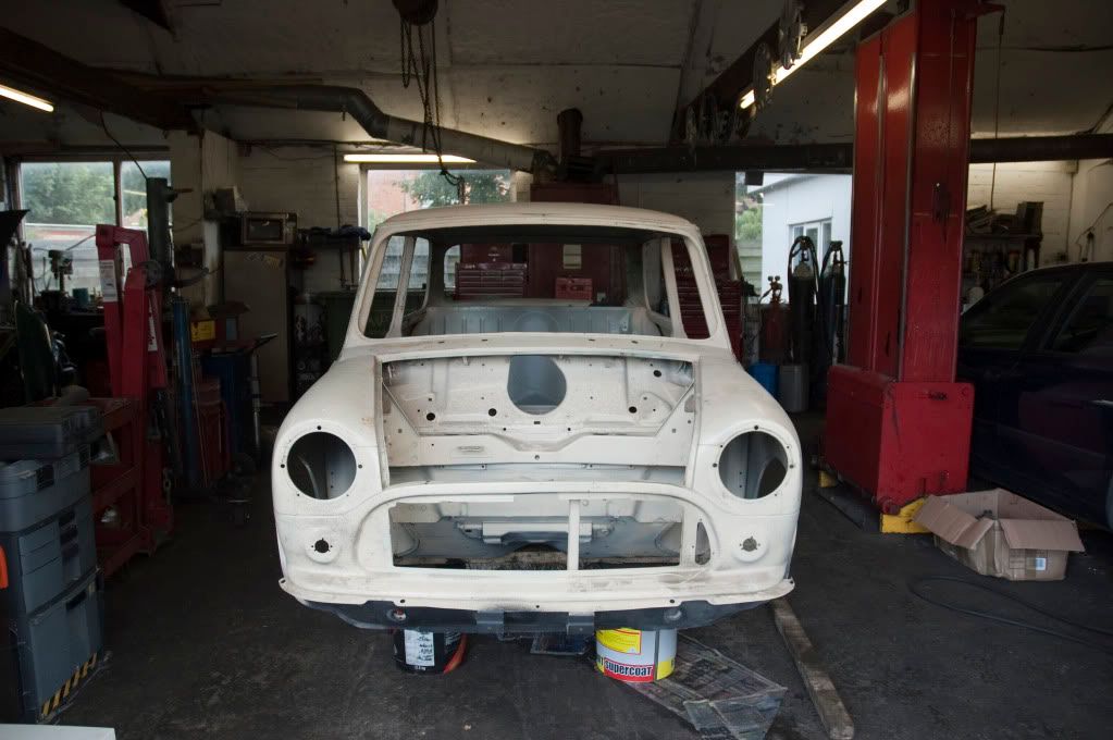

In the process of lightening the shell as much as possible.
Front end got hacked off
I used the inner wing brace as a guide to cut up too. I'll run a butt weld across those top to stop the panels from separating.
Remains of the spot welds were ground back and on this side the scuttle corner was perfect. Unfortunately there are one or two tiny holes on the other.

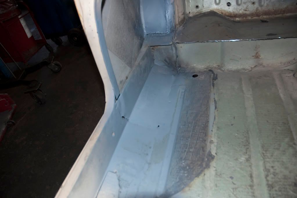

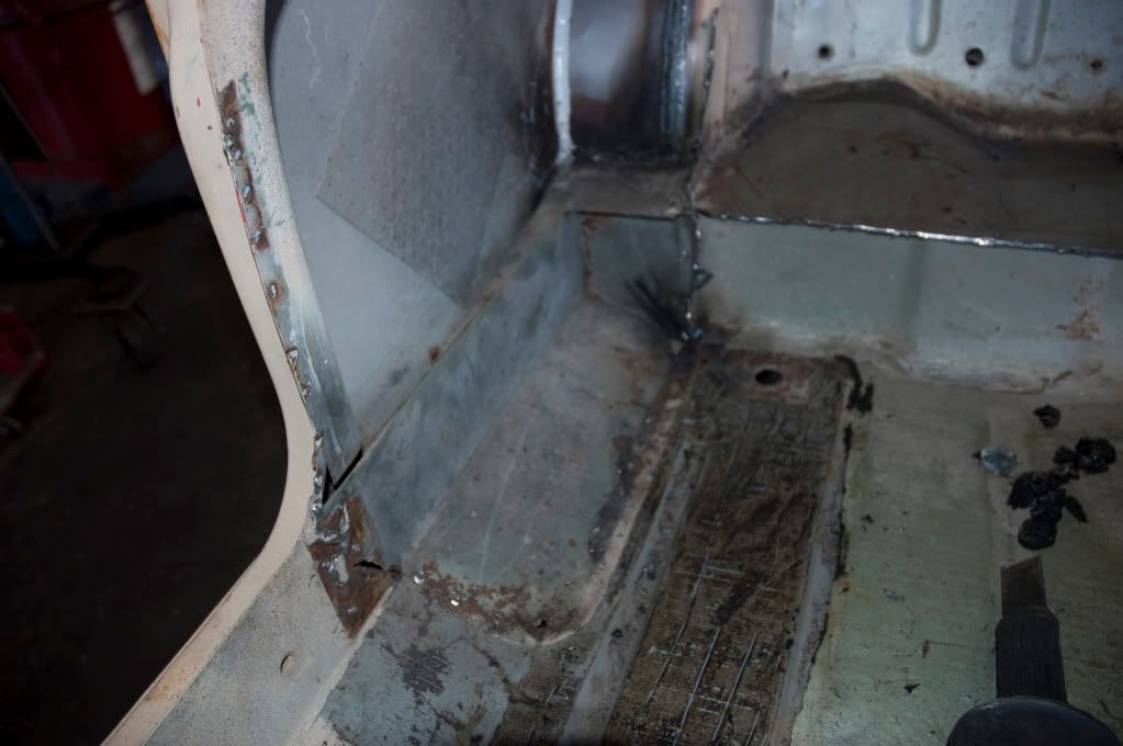

Moved onto the rear door bins and seat squab.
Oxy-acetylene torch worked a treat to remove the sound deadening *smiley*
Seat squab was shortened.
Door bins were removed, like a muppet I punctured the inner sill with my cold chisel. So next time the welders out i'll have to fix that.
Ground back all the spot welds and after a quick coat of etch primer I was left with this.
Still have to do the other side and tidy up the seat squab, hoping to head up next week sometime to finish it off.
