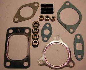

all these turbo drivers and no one can help me out on the gasket between turbo and eblow or the studs to hold the elbow :(
i think its one of these but they are the wrong size

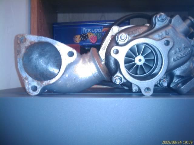

i have a piccy that may help too
http://turbominis.co.uk/forums/index.php?p=vt&tid=170151
i think avonbar sourced mine the ones i couldnt find i made, copper sheet and tinsnips once cut out i heated them on the gas stove and let them cool(was told it softened the copper)
worked a treat for me and worth a shot..
as for the studs i dont know the threads *happy*

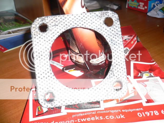

cheers guys, i've got a mate who made the below for his car out of exhaust gasket "paper", obviously not paper but the metal stuff. so if mr 1293 sprite cant help I might go that route.
do the bolts need to be anything special considering the heat thats going to be involved? not sure a pack of M8's from a DIY store will cut it?

i use red hylomar, its called 310 and we use it on all the turbine casings.
its worked perfectly on that join, better than exhaust paste.
i was planning on just using some stainless m8 studding

Rod, your a diamond, as soon as I read CAM6677 a light bulb came on, I knew I'd seen it somewhere before:
http://www.avonbar.com/prodMain.aspx?range...Id=227&makeId=0
at least i now know thats the right part, avonbar need some piccys!
now to work on the bolts, as you say their all different, i'll see what i can find in the way of studding.
