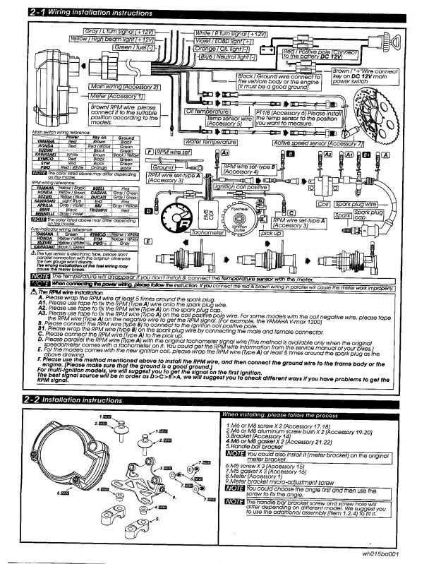

I don't mind wiring everything else in but I was just wondering how would I get the signal to the tacho. excuse my ignorance, but electrics are one aspect of car ownership I've not got involved with.
Would the signal just come from the existing feed from the coil?

I've got the 10k version of that and was playing about with it last night.
Picking up rpm can be done in many ways, you can take a feed from the coil, from the spark plug itself or by wraping the wire around one of your HT leads.

I've just scanned the instructions for a clearer explanation :)

well i found the instructions and uploaded them....

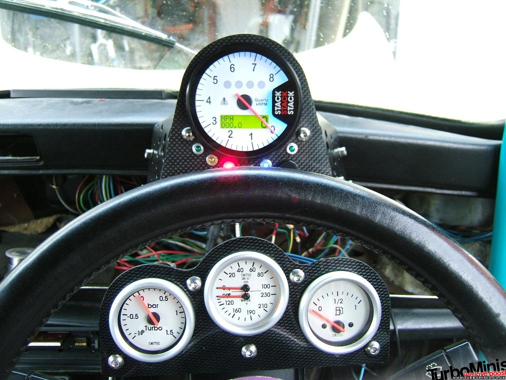

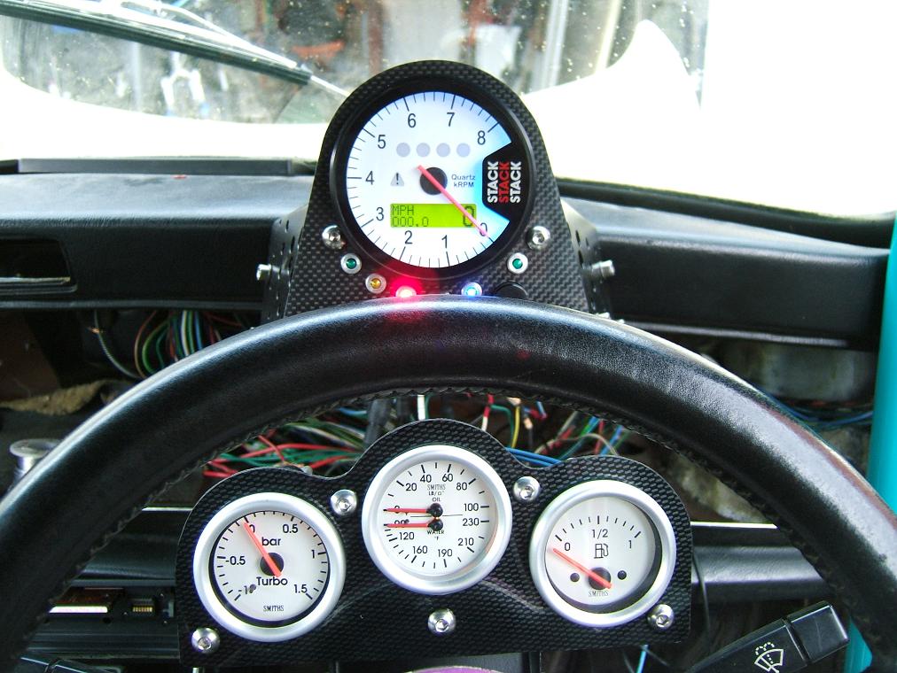

Thought I might say that I have this more or less wired in now and it seems pretty good. The 2 stage shift light came in useful at castle combe at the end of last month. you can programme it to go yellow at say 6500rpm then at 6800rpm red.
I just need to figure out how to wire up the fuel guage as I ran out the other week. My car is even worse on fuel then I thought (that makes it really bad)
That said the light show when you turn it on looks awesome, though may not be to everyones taste.
