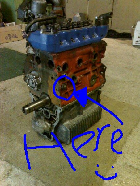

ok thanks. il try another oil guage first, but were's the releaf/release valve situated? Ive never touched it before! lol
hang on ive got an idea...
*happy* runs to find a pic *tongue*
*happy*

lol thanks alot pal. should be able to sort it out now.
