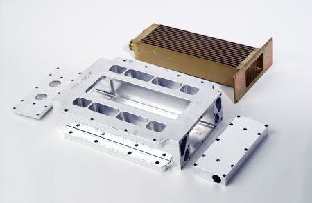

just checking..Anyone know anything about the charge cooling plates above?

I have talked to a company in aus about their intercooler kits for commodores, they sit under an m90 ontop of the inlet in the aussie v6 engine, a small rad core with water being pumped through, i figured i could make it work with my sc12 kit, however its much too large, he even gave me a cad drawing of the measurments
Would be great if you could share this as i maybe able to adapt for the M45.
