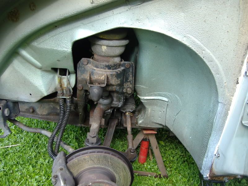

Found this in another thread:

also, make a note of the shocker mount position on the upper arm. do you want shockers pointing inwards?
