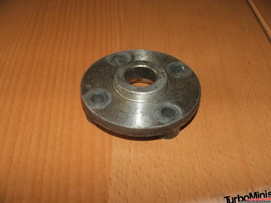

The spacer I have does not look like the ally Minispares one, its a wierd shape
Oh and its 12mm
And for sale if anyone wants it
Edited by Sprocket on 27th Sep, 2009.

that looks like a drive flange off an old pump! *happy* just a thought!
I made one a while ago, needed to be about 10mm i think.
But i've also had some of those thinner steel ones.
I have no idea what that is off Sprox - never seen one like that!
