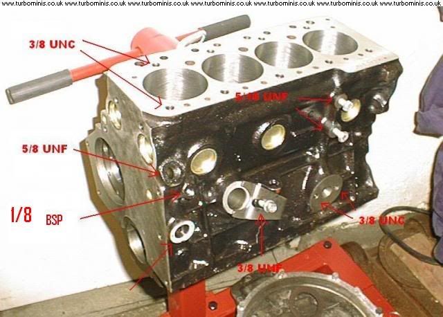

I need to get some sensors to connect to my Stack. Does anyone know what thread sizes the water temp sensor is and the oil pressure sensor.
thanks
http://www.turbominis.co.uk/forums/index.php?p=vt&tid=119056
Am not sure if the water temp is 5/8. could be completely wrong tho.
All i did was got a standard mini temp switch, cut the end off then drilled and tapped it to take the stack gauge.
Rick
Temp sensor fits the head not the block and it is 5/8th UNF
Oil pressure is 1/8th BSP not NPT
Edited by Sprocket on 9th Oct, 2009.

Cheers guys, i did try a search but didn't see that hread, its an excellent picture.
Yeh the link is goood only for the fact that the piccie is wrong, lol, topic locked so no one can point out the mistake *laughing*
whoops, can fenton unlock?
infact, cant i just swap the pic?

LMFAO Joey *Rofl!* its still wrong.
Come on chap, the information is here for everyone to read *wink* I'll give you a hint. Just try and fit a 1/4bsp fitting into the oil pressure tapping *wink* You must have read what I typed as you have changed the piccie to show BSP instead of NPT. Mind you, its the sort of thing I do, lol
Edited by Sprocket on 10th Oct, 2009.
fluck me, had enough problems trying to post this pic years ago, if this one is wrong, it can just stay that way haha
