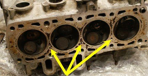

What are these holes for?

I think those small holes are to allow any air escape, not sure there will be any use for them on the A series block as i think its solid where they end up.

Oh, and those three little holes are to prevent steam pockets between the bores. I dont have ANY holes between the block and the head for coolant, and it doesnt appear to be an issue
