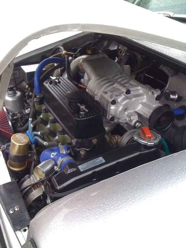

had a sucessful visit to vmax yesterday to have my brothers car setup, which I've built a S/C 1380 engine for.
the supercharger kit was bought in the auction at the London to Brighton run.
breif spec:
1380 block
cast omegas
vmax s/c cam
vmax supercharger kit
1.5:1 roller rockers
rebulit box
s/c drops
m/s 4 pin diff
ended up with 142.1 bananas and 127 Curley wirlies
and one happy brother!
I'll get some pictures up sooner or later

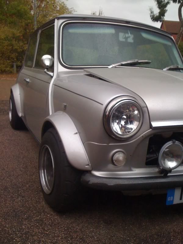

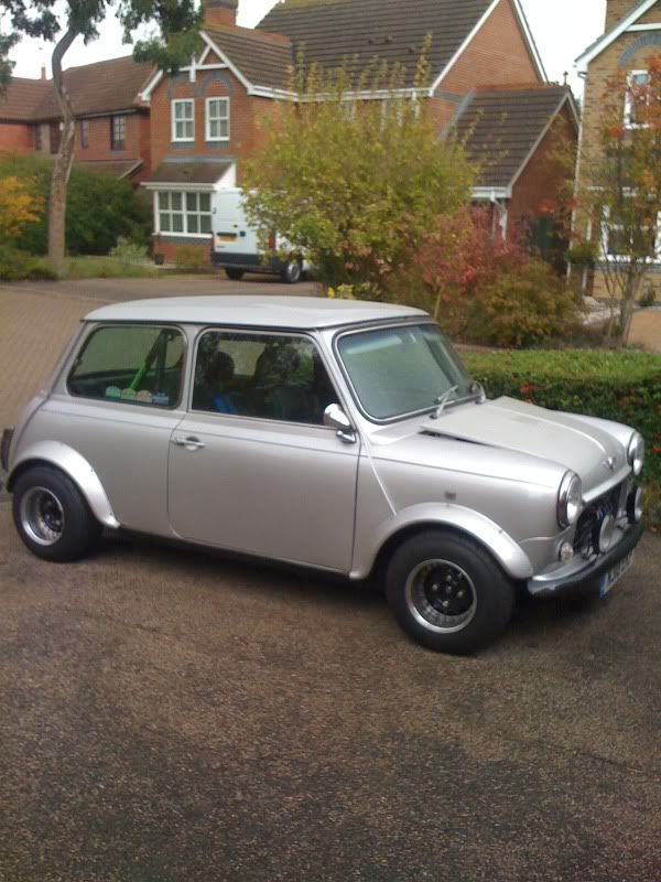

so this is his car, its a german silver bullet limited edition spi cooper converted to carb and now supercharged.
outside its got carbon bonnet (not fitted) and carbon bumpers and 4 of carls finest mini special split rims with yoko a032rs and the standard silver bullet arches
suspension wise is got gaz lowered dampers negative camber lower arms and Kad h/d tie bars
inside its got leather cooper seats, momo wheel, roll center cage and a kad quickshit
and the engine as you know is supercharged
i do all the work on the car inbetween building my own car.
few pics off my phone

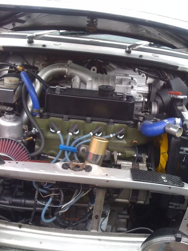

Have now fitted a omax rev limiter and shift light, as I found out what happens if u go over 6000rpm, 11 bladed fan! No more oops teach me for showing off. Thanks Andrew AGAIN!!!!
Low, fast and aggressive looking......
Doesn't imitate something it's not!!!
Now a "Super Bullet"
Prawn
667 Posts
Member #: 5232
basingstoke
really? sounds like a strange one to me Richard!
I've got a plastic 11 blade fan on my 1380, with the blades cut down 1'' each, and it's been revving to 8k a few times a week for over 4 years now!
1380rich
484 Posts
Member #: 4755
warwickshire
good job looking ace!
andywaller
646 Posts
Member #: 1826
Maldon Essex
7000 actually!
prawn you probably haven't got a s/c to whip into you blades though.
there wasn't enought space between the belt and the fan and the belt just jumped and caught the fan blade.
vmax did say keep it below 6500 and it would be ok.
it's all repaired with no real damaged except the fan. took a couple of hours last night, wasn't too bad. I even had the Charger completely off and on again to do some unrelated work!
