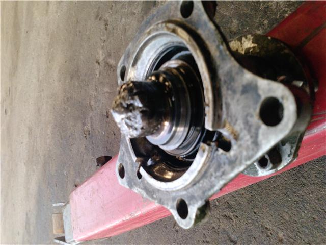

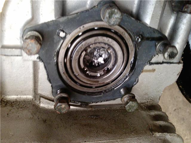

1380rich
484 Posts
Member #: 4755
warwickshire
heres the damage *frown*
Ben H
3329 Posts
Member #: 184
Melton Mowbray, Pie Country
Nope, can't suggest a better one. We have broken 1 in 4 years with big slicks and driven very hard, so not too dissapointed.
