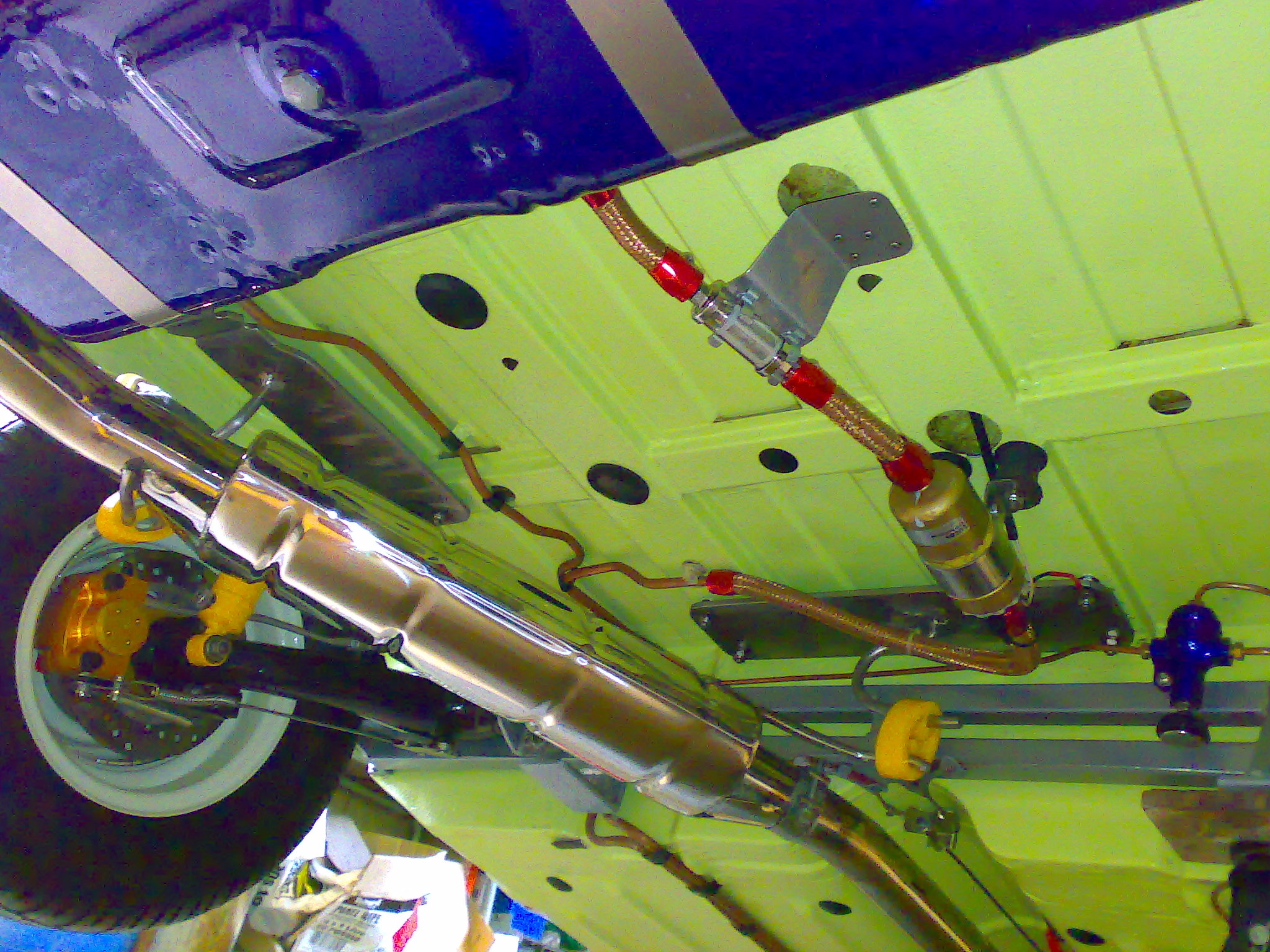

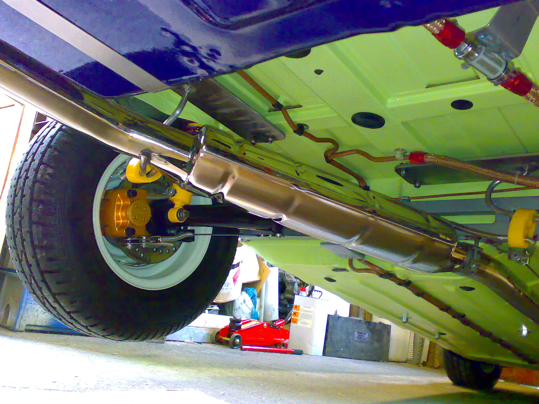

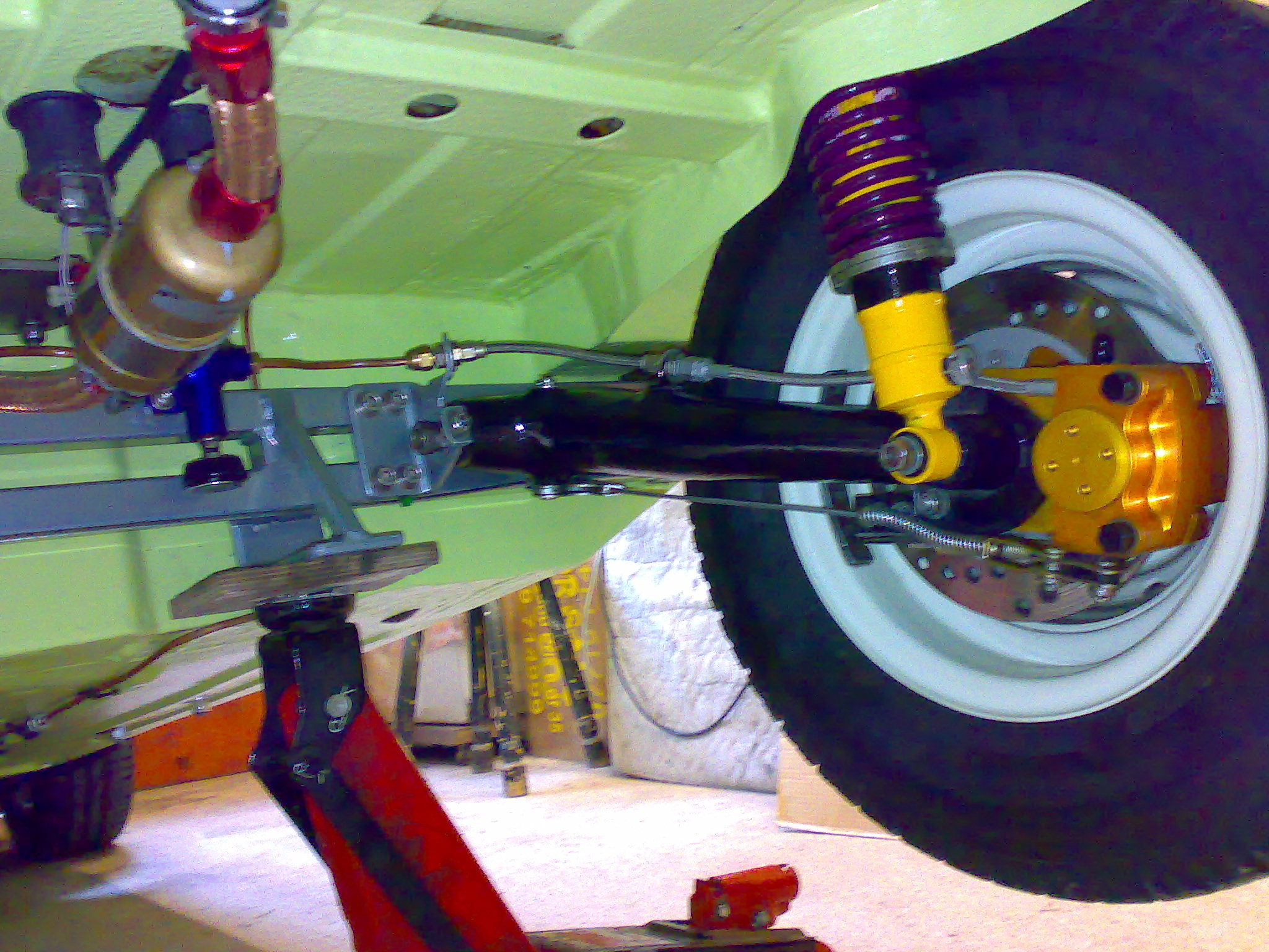

turbominivanman
1105 Posts
Member #: 1504
Westbury, Wiltshire
Pictures are easy.
These show the setup on the van where I'm using KAD rear discs and calipers which have a spindle and internal cam which presses on the back of the piston. Yeah this is independant of the fluid system but I'm pretty sure you'll struggle to modify a pair of calipers if they dont have the mechanixal feature already fitted.
Wilwood are the only other ones off the shelf I've seen.
I've also seen Peugot 306 and Skoda Fabia calipers fitted which I think have cable operated parking brakes.
Making and then welding or bolting the normal centre cable runner from a subby to the beam is easy. Radius arm quadrants can also be used in the usual manner.
Reading the MoT regs is over to you.
Good luck.
Richard.
