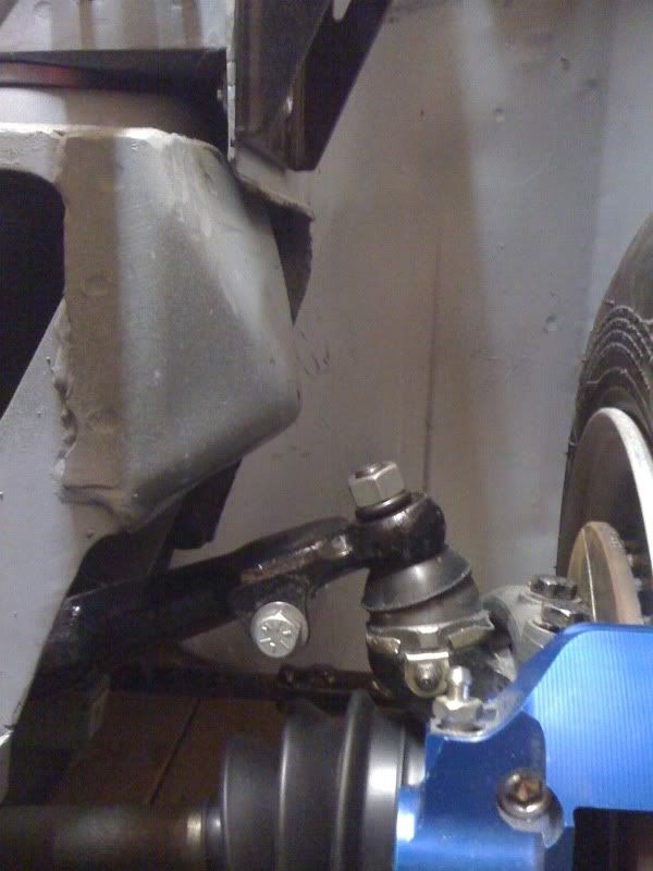

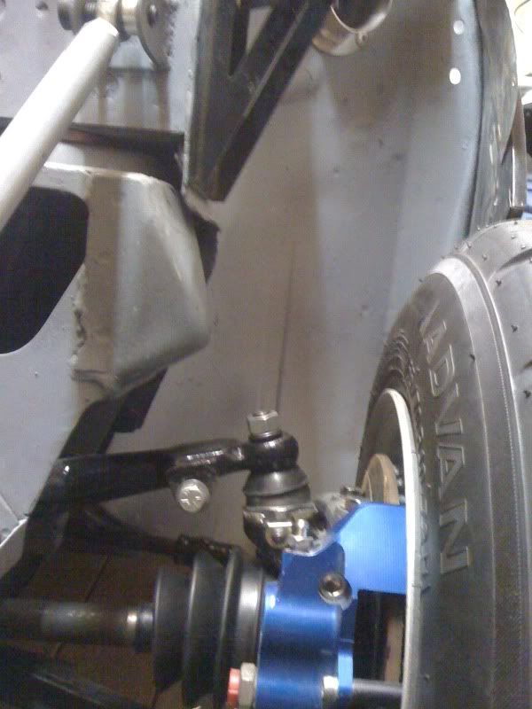

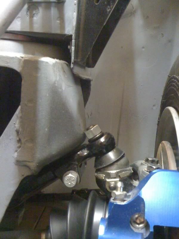

So I'm measuring up for my coilovers and trying to work out open and closed lengths but I don't know if I'm going about it the right way.
ok so the pictures show my suspension at full droop (using thicker droop stops as advised by JF. The distance between the top arm and the subframe at my intended ride height. And the suspension at full bump.

I have a few problems with what I'm doing.
in my building prepping and racing your mini book it says that you should check the angle at which your top ball joints lock up, but my top arm hits the subframe before this happens, is this right?
also how much bump travel from ride height does a track car need?
and does this look like enough droop?

then I've just found this in the same book.
ian curleys origional miglia at ride height.
there can't be more than 15mm full bump.
(I'm getting good at this, this whole thing has been done on my iPhone from taking the photos uploading them on photobucket to linking them on here, I don't have a pc!)
Do you not have the subframe fixed to the body without the solid mounts between body and frame?
There is a good 3/8" at least, and how the mig boys do it. That should improve the bump distance?
I also remember that on Will and Bens TT2, they completely cut out the area on the tower where the ball joint hits. And I was also lead to believe that the ball joints dont lock up untill they are right up there in the tower?

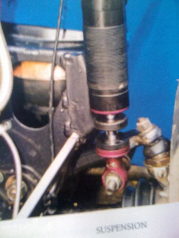

This is what it used to look like! I cannot separte the image out for some reason! But as Will says make sure it does not bind at full travel!
