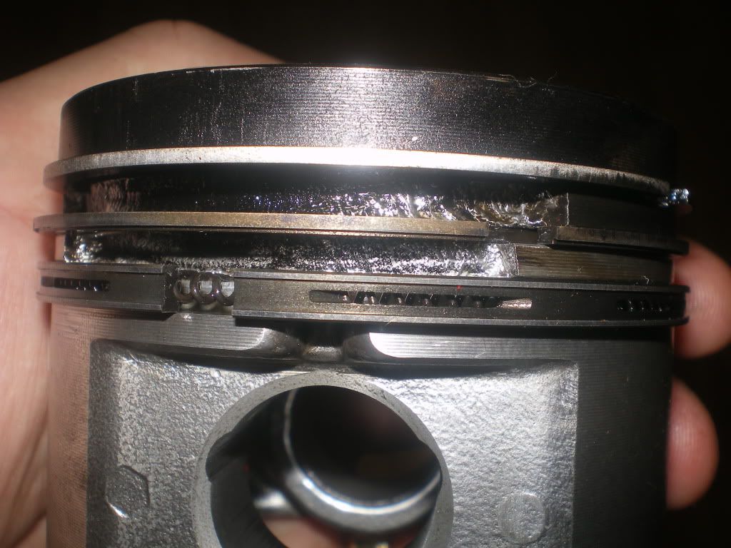

Thats fine stick it back in
detonation

rings dont look bad lol ebay the ring set?
Pistons are an expensive paper weight now !!

Ahh well lol ... The Omega's are now fitted thanks to benross ..
i've seen worse, but 8 out of 10 for efforts :)

One has to try lol ... very costly though.. just wanna drive the bugger !!

Bit of chemical metal and that'll be right!

question.. how long do you reckon those would have lasted(standard pistons) if fueling and ignition were spot on and running medium to low boost? The same will just happen to the Omegas if the fuel/ign problem is not sorted, will it not?

apparently not mate , Benross has lowered the CR ratio by opening up the chambers in the head + the omega's have a 10cc dish . so now the motor is a low C motor ... hope that makes a little sense as it dosent to me ..

i am a bit worred that mine will look like this when i get my finger out and split the motor

well again in theory mine should not look like this as ive had no detonation and a nice CR
but i do have mega's

well all my standard pistons had bits missing .. the crancase comp was hurrendous .. oil n smoke bellowing out of every orrifis :(

Quite a while, I'm sure that there are a couple of people on here producing decent power with stock pistons, just racking my brain to remember who.
i heard the std turbo pistons was very good

iv had it aswell :(
the previous owner is a complete tool! built the engine with a compression ratio of 12.5:1

Ahh.. im talking of standard 1275 pistons, not the turbo ones. Have a rebuilt engine with a cr of 8.5, and thinking of running low boost.. 6-7psi. but i understand I will have to make 100% sure the AFR's are right with not much advance to avoid det.
They have a much thinner crown, so it will take a lot less detonation to kill them.

That I understand, though how does a thin crown relate to land breakages? Is that not just down to the piston being made from a lesser quality alloy?
My theory is that standard pistons would be fine with the right CR, fuelling, ignition and decent IC up to 10 or even 12psi.
I base this on my 998 that runs standard pistons. I also ran the 20773s with 18psi and they suvived when everything was fine.
Buying pistons to compensate for bad setup is piontless, but I guess no-one would argue that point.
im confused ore the pistons picture both the metro turbo pistons?
btw mini93 that looks like it did the bores too :(
