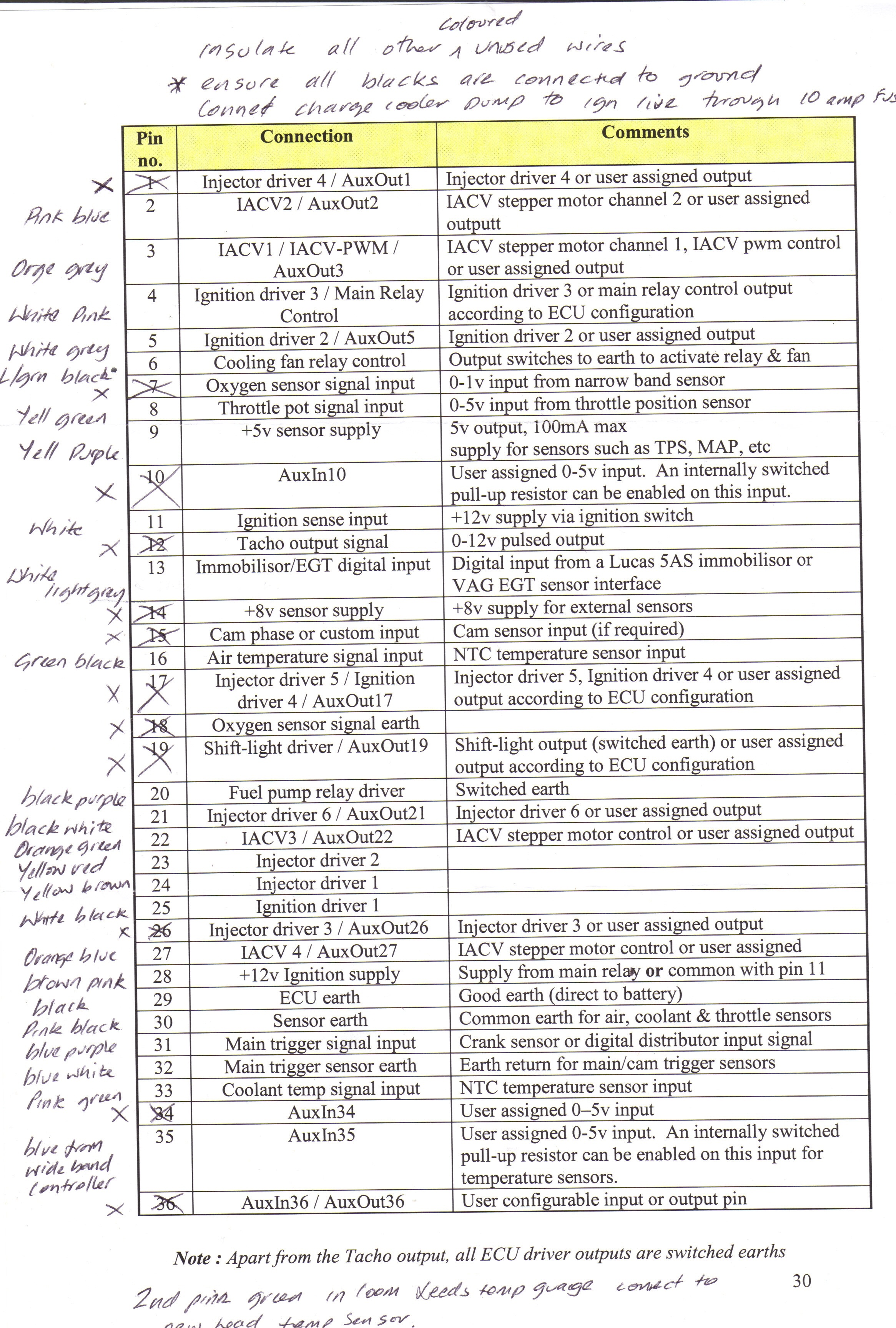

Hey hey,
I've recently stumped up the cash for the Vmax MPI150 kit.
I'm looking for some advice regarding splicing the Emerald to the original MPI loom.
I've decided to locate the Emerald in the cabin, so I've made a seperate loom, now I'm having some problem in working out what wires on the original loom to join to the wires on the new loom.
Stuart Gurr has sent me some pin data, but I'm still not 100% sure about it.
I've cross referenced what Stuart has provided with the MPI PIN data from both an exert from CAPS and Autodata (I know Autodata is a pile of pish at the best of times when it come to the Mini).
So I was wondering if anyone else running Emerald on the MPI could offer some spot on advice?
I added an attachedment of the PIN data Stuart provided.
Regards,
Rob
