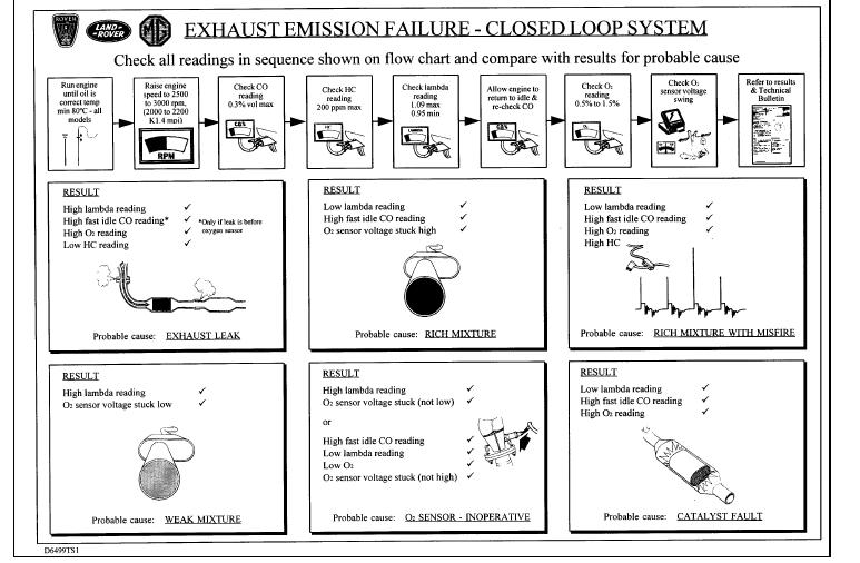

Comparing those results to the ones below from a perfectly executed test, it would perhaps be due to an excess of unburnt fuel and oxygen either from a slight misfire, or poor valve seal.
The check list I have attached says its an exhaust leak before the lambda sensor, which would be the manifold to head gasket.
Do all the simple things listed above first though, especialy the valve clearancies

That's a bloody usefull diagram Sprocket
Its by no means a definative chart, but it groups the different readings together which gives you a better idea.
Reading tailpipe emissions after a catalytic converter is a bit of a science experiment, as you have to work out if the cat is working first before you can decide where the problem lies.
Have a look at this one for the chemistry*happy*
