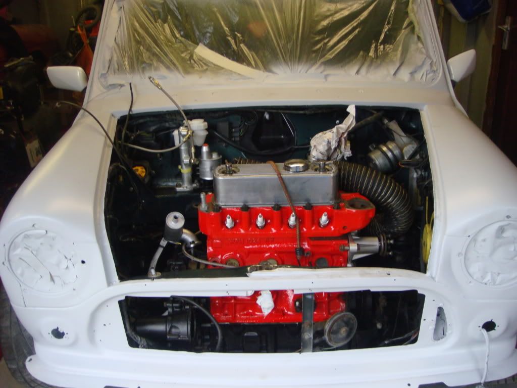

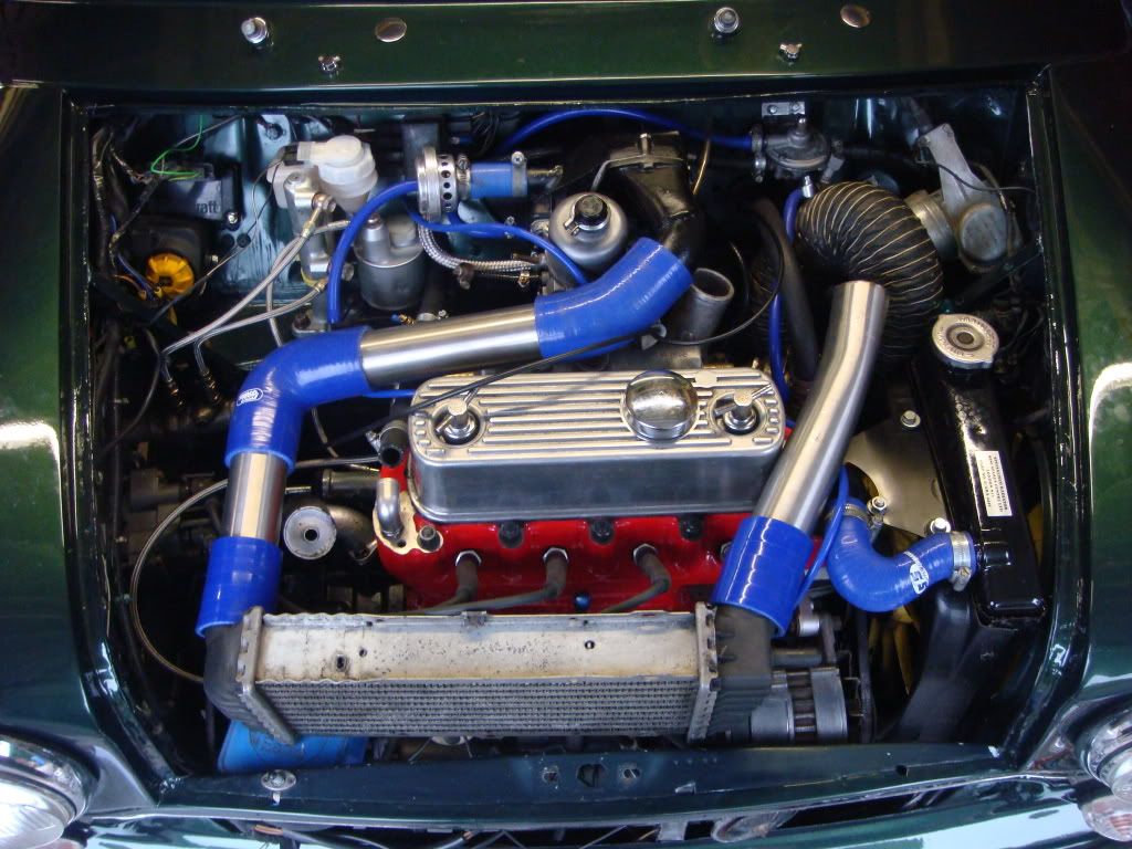

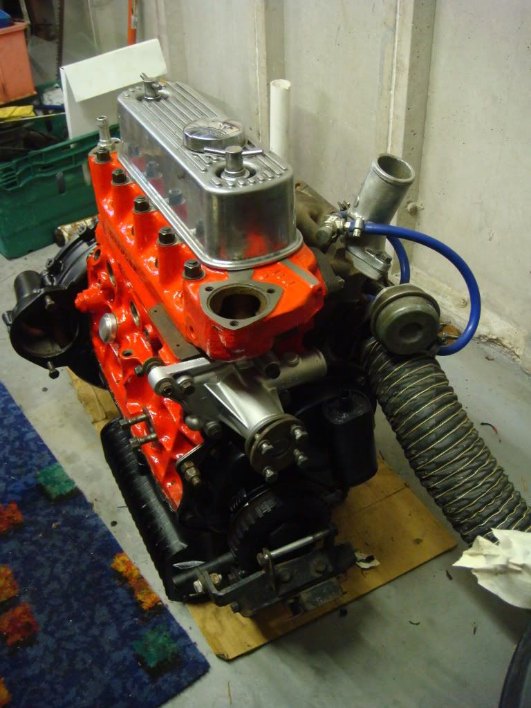

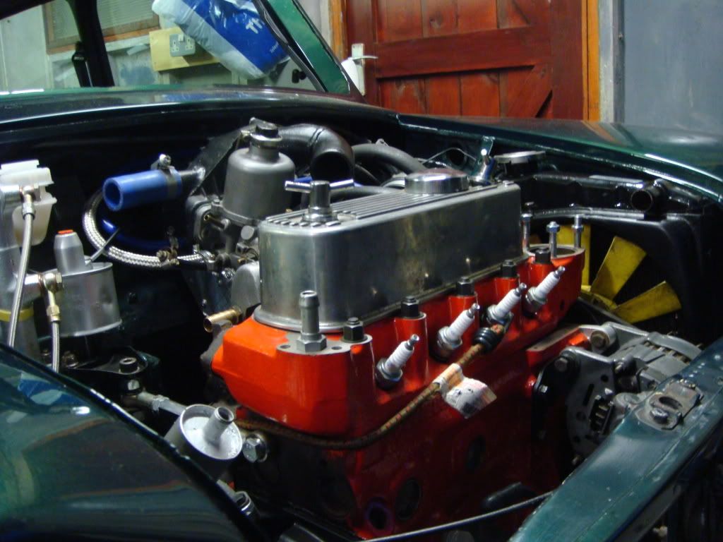

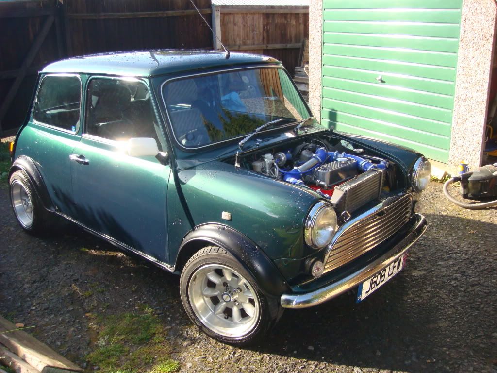

just thought id post some pics of me build. spec is as follows.
bored to 1293cc
minispares mega pistons
recon s/c box with s/c drops
minispares x pin diff

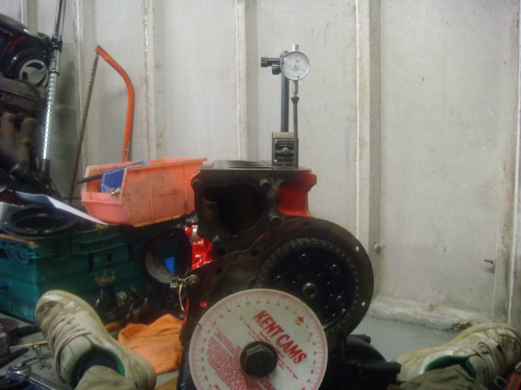

phase 2 cam
vernier duplex timing gear

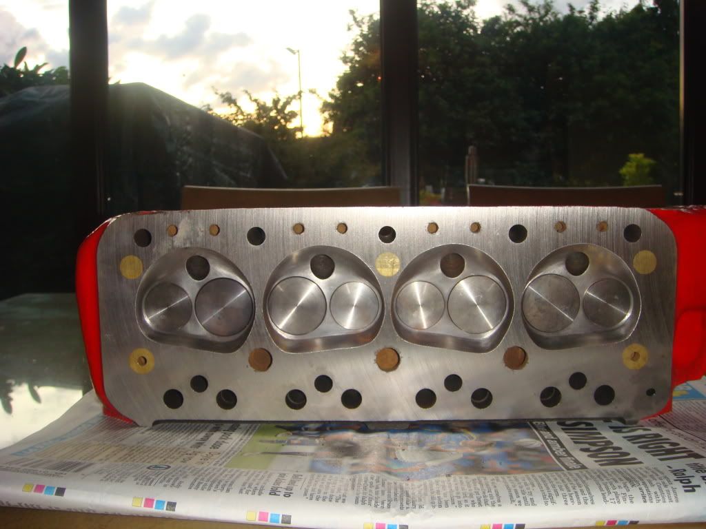

cylinder head modified by turbo phil. 36mm inlets 29 exhausts,ported, polished, manganese guides, 28cc chambers.
re built t3 turbo

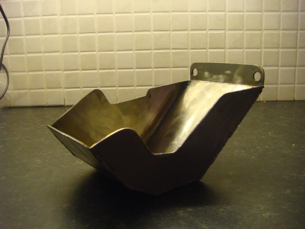

home made heat shield
supercool 2 core rad
intercooler from ford scorpio
megajolt ignition system
hi-lo suspension with spax shocks

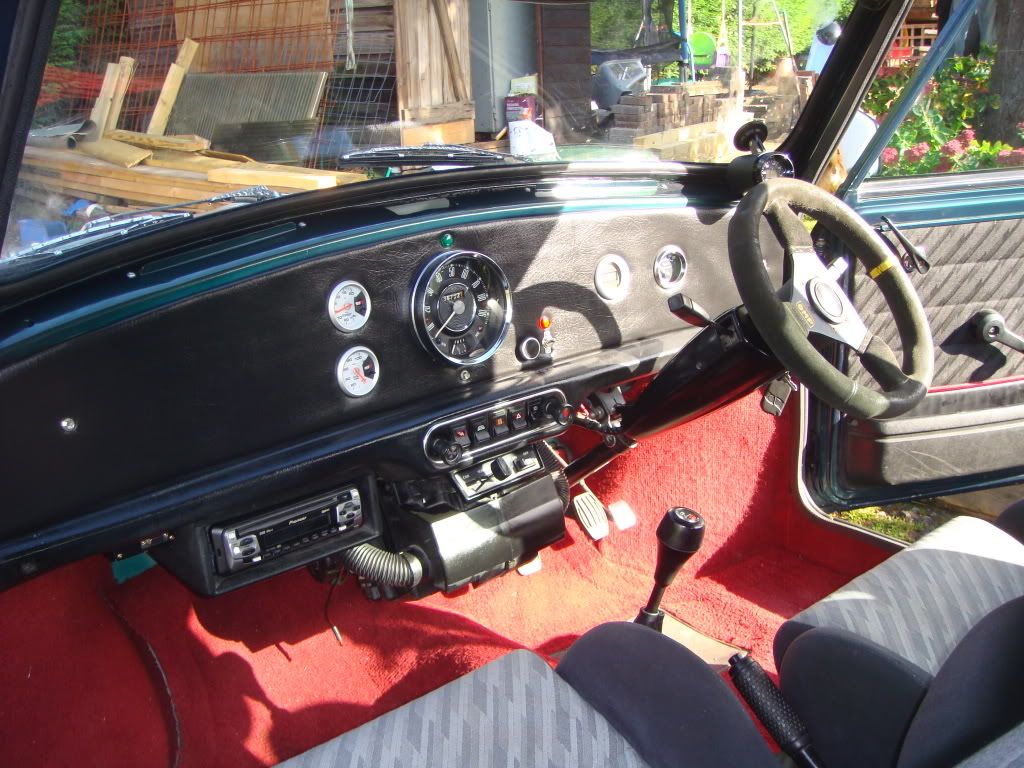

custom made dash
currently running 10 psi, not managed to get it on the rollers yet but hoping for around 130-140 bhp at 10 psi. As this is my daily drive i think that should be plenty.

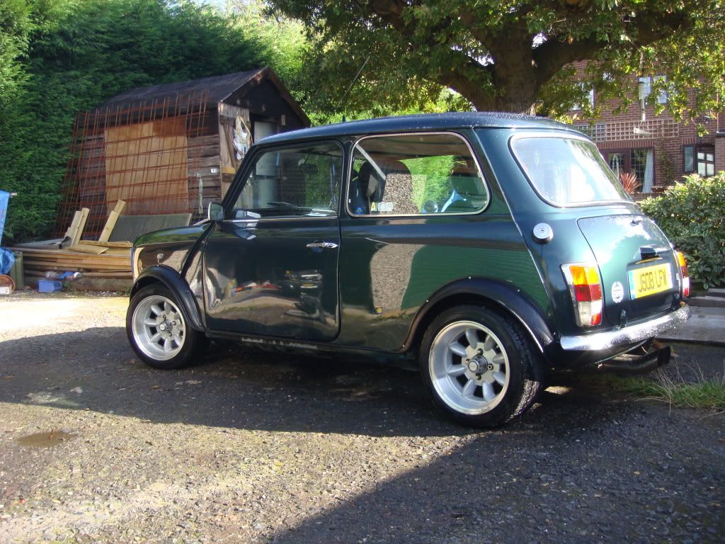

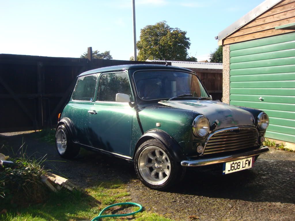

unfortunately i had a friend respray some of the car for me, and now the colour on the door does not match the rest of the car, so this needs spraying.

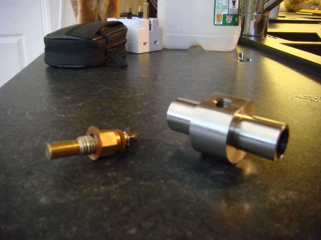

made this at work for the water temp sensor to fit in to. sits inline with the water hose.
few jobs left to do, spray the bonnet, underseal the floor, refurb wheels, sort the paint out.

EssexSteve
556 Posts
Member #: 7029
Wickford Essex
looking good, rolling roaded yet?

I just bought one of those in line temp doo dahs of ebay...

Nice work Jamie, looks a hundred times better!

very smart looking! i like it

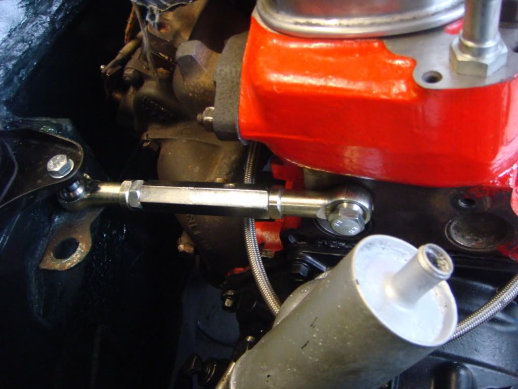

Very nice, is your clutch arm a little bent?
Are you questioning the sexuality of his parts?

well done mate, drives nice this time too :)
is it holding 10 psi ok?
those arches look good should have got that guy to do all the paint for ya *wink*

im pretty sure the clutch arm is straight gavin, hope so anyway!
not really holding boost that well m8 seems ok in second then drops in third. also 4th's leaning off on lambda.
need to book it on the rollers me thinks.

Do you still use the original fuel feed and return lines or bigger ones ?

ive up graded the fuel lines to 10mm feed and return.
