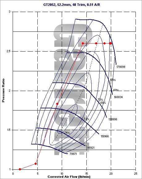

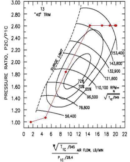

Been playing with turbo ideas again and foudn this site:
http://www.squirrelpf.com/turbocalc/
So for the lastest engine I am building I plumbed in the data and chose two turbos...
Not alot in it from the compressor maps it would seem!

interesting, threw in a few figs for an optimistic 150 banana 998 and got these:
http://www.squirrelpf.com/turbocalc/graph....7&product_id=19
http://www.squirrelpf.com/turbocalc/graph....7&product_id=20
http://www.squirrelpf.com/turbocalc/graph....7&product_id=75
looks like the old T3 isnt too bad a choice

The compressor map isnt the be all and end all - its just suitability if you like.
Would be intresting to run the same engine up on both turbos and see!

Yes the T3 looks perfect for the 998, and it made good power when we used one. But the inertia was massive, which killed drivability. fine for a drag car, rubbish for anything else.

so this is probably where looking at the turbine map would help choose a turbo....

Ok found a gt20 turbine map
So now I need one for a t3 and the calcualtions for what exh flow an a-series might produce.
Alex

I still need to know what real world EGTs people see on an A-series and a turbine map for a t3 with a 0.25 exh AR.
Then we can look at what will boost when etc *happy*

I measured EGT at 700 Deg C on the outers and 800 Deg C on the inners, so that is why i used those figures in my calcs.
I doubt that you will find a turbine curve for the original T3 turbine.
I'm not sure why you are pursuing the T3, other than it is a simple fix.
Just look at the cars with the highest State of Tune at the RR day. They were running GT turbos.
I think that I can safely say that anyone who has upgraded to a GT from the T3 has not regretted it.

I have ports to measure EGTs by have never got round to it on my mini. So around 700-800 at the turbo?
Well I currently have 2 different GT turbos and 2 T3s to play with...
On my car I don't mind trail and error - on a customers car I perfer to know what will and wont work first. Or at least to have a good idea!
The other reason for still bothering with a T3 is that if you look towards 300bhp then you will struggle to find a compressor map that isnt going to surge its tits off - not that I have a 300bhp engine in the wings or anything, just as a theory exercise lol
Alex
There is potentially 300hp in the Gt2056 without surge in my opinion.

um ,chaps , surge is on the left side of the map, overheating and overspeed choke is on the right . *wink*
Well, I understood Alex to be saying that if you can find a turbo big enough for 300hp, then at low revs you would be running into surge. i.e. the left side of the map.
Thats what I thought too Paul.
6753 Posts
ah my mistake , i thought he was saying that as it got towards 300 bhp power output it would start to surge .. i must have misread it .
in reality , you would only get surge from a 300 bhp map , if you sized the a/r of the turbine housing too small to avoid it .
