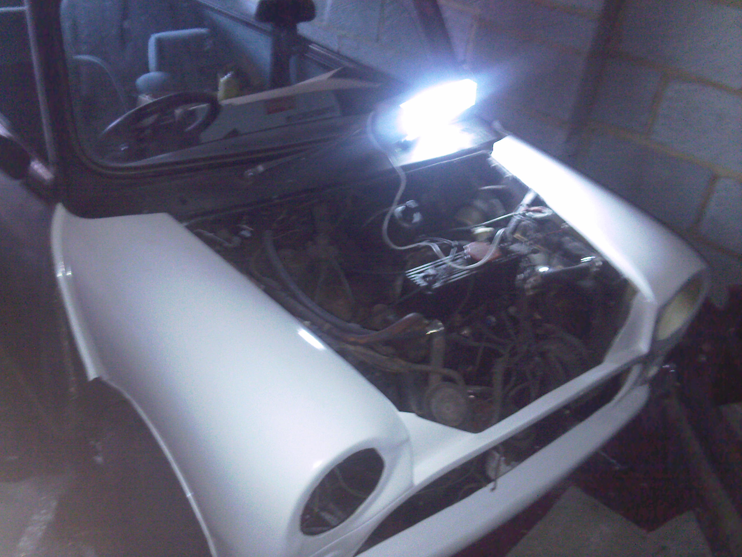

anyway, got the flip front roughly trimmed to size today, just need my fasteners to turn up now...

ok, with the death of the 7 port I need to get this mot'd so i have a car, and also to free to room up to get the 7 port in to pull the lump,
the rot was worse than i thought once i started poking things (isnt it always!) so far i have fitted new A panels new flitch, new scuttle, flip front and new pass side inner and outer sills and floor pan.
next weekend should see the the sills and floor pan on the other side done and the doors back on.
then i have the roof and flip front to paint, dash to refit, front lights to fit and cooling system to install (cinq rad)
