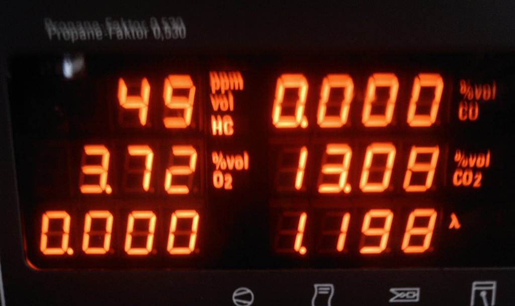

I went to a garage to verify the CO values, before going to the MOT, but there's still a problem. The lambda value is still to high.
I joined a picture, engine is idle.
I checked everything, reinstalled the exhaust to be sure there is no leak.
My last MOT control 2 years ago was ok. the only modification i made since is to install a 1:5 rocker. Do you think if it can influence on the CO emission and lambda value?
That's running very lean. You need more fuel.
Have you checked the fuel pressure?

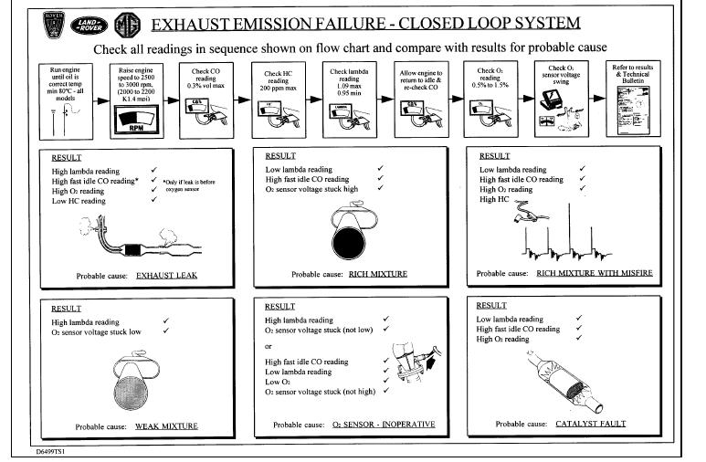

I recon that could be a leaky exhaust.
Idle with 1.2 lamba will ve VERY unsteady, if it idles at all, and the engine would faulter when the throttle is applied.
What also confims this is that the CO2 is not far off reading right. No CO and minimal HC means that the cat is working its magic. 3.7% O2 does not represent the lambda value of 1.2. The O2 could be from a missfire if the post cat temperature is hugely different to the pre cat.
