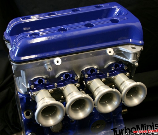

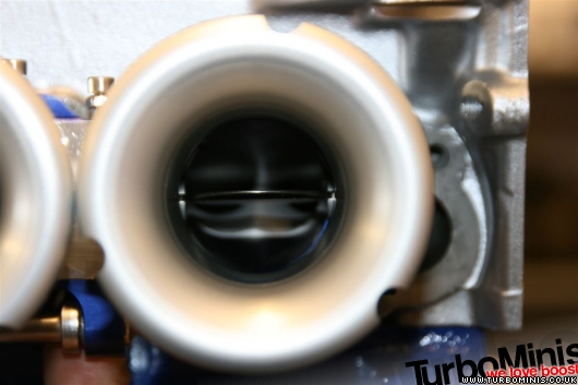

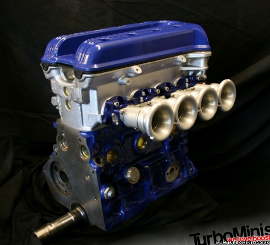

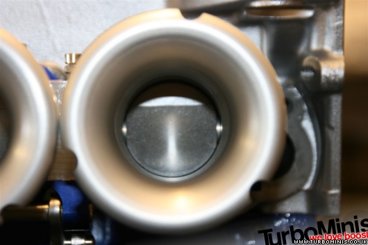

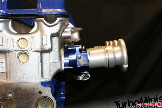

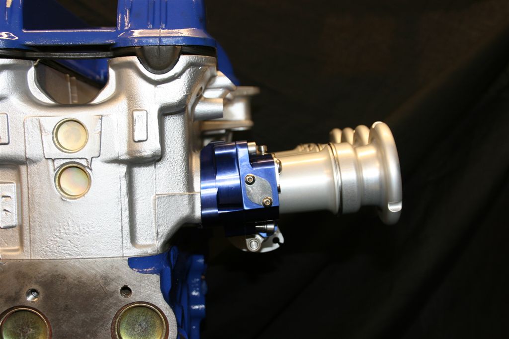

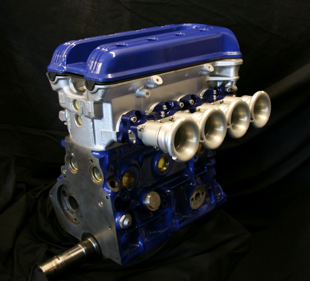

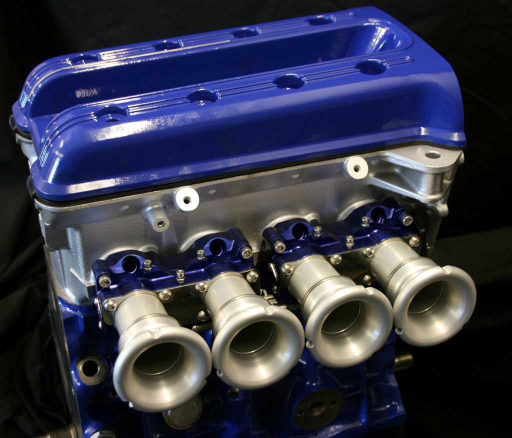

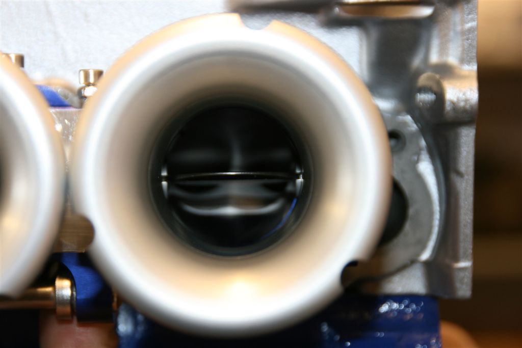

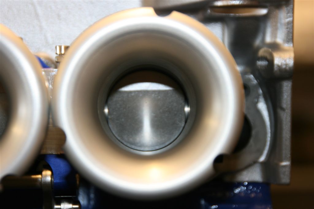

Looking to push the little K as far as it'll go we have designed some "direct to head" bespoke throttle bodies for the K conversion. 38mm plates but there are no shafts in these bodies so effective area is up to the equivalant of a conventional 40mm body with a shaft in it. We have downdrafted them by 5 degrees to allow a little extra clearance to the slam panel and the use of a full one piece filter.
some pics to drool over!

I had a look at the full piccys in Wymondham earlier. They are properly hot looking items... But I doubt my 8 valver really needs them!

Very nice John
www.miniman.com.au
They look very nice John as usual from you, is that butterfly tapered on both leading and trailing edges?
Ive been looking into making a spindleless conversion for my Weber recently
