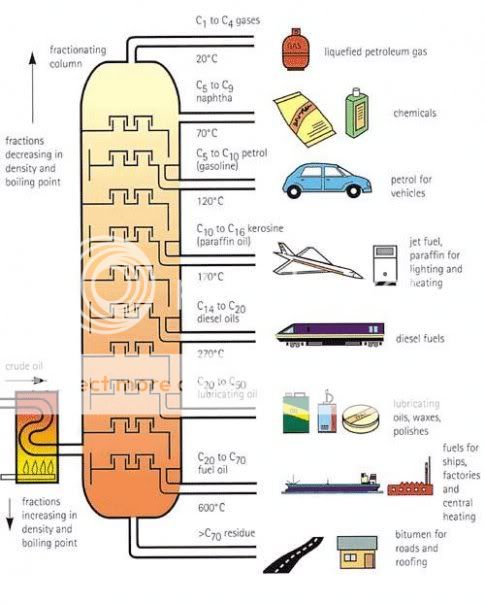

Or for us simpletons, a picture of distillation.
Edited by Oli on 28th Dec, 2009.
Yeh, like 'simple' for kids
The pic does not tell you that gasoline straight off the cracker is around 70 octane nor does it tell you about cat cracking. But then if all you want to know is the kids simple version then I suppose the picture will do, lol.
I work in and around oil refineries. I just have a natural curiosity that the picture above cannot satisfy *happy*
Not that I am putting the picture down, its just a bit simple thats all

I'll be honest and say i didn't actually think theres was that much more to it, if you know what i mean.
But now i think im going to have to read the link properly.
