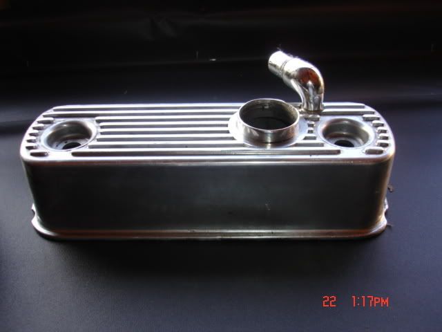

probably best to put a pic of your rocker cover up....

ook will do but its just one of the basic alloy show off ones.
its only temp as want to get a mini spares or an original metro turbo one

this is my rockerwith breathers
The other thing with these rocker covers is that they have a flat spot to the right of the filler cap.
I have one and was going to drill + tap for a banjo bolt to put a breather pipe on, but I have a better rocker cover now...

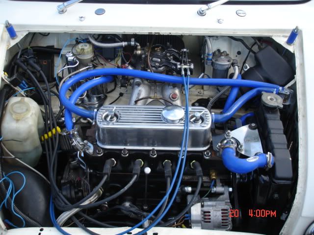

this is what i did, its just a combination of pipe fittings from B&Q.
Hope this helps

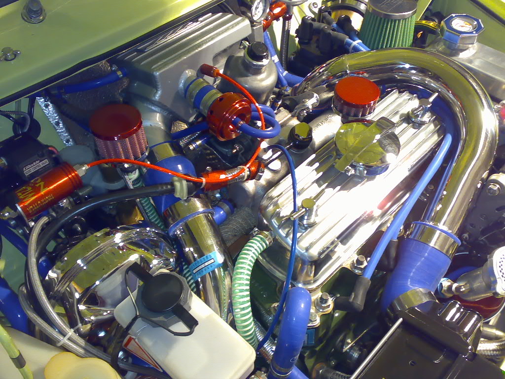

or this

Whow, Luke, that is a neat install !

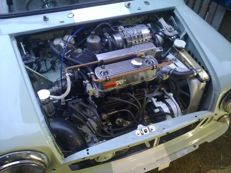

I've attached a pic of my breather install on the van which has two K&N engine breathers. This may be of use.
One breather filter is fitted to a 1/2 inch 90 elbow, JB welded into the back of the rocker cover and the other one is fitted on the outlet of the transfer gear case. My pipe from the rocker that goes down past the intercooler pipe, actually T's into the transfer case breather.
I do not have a breather on the timing cover as I have an early belt drive which does away with the breather outlet.
The important thing to remember is that whatever setup you decide, and this includes the simple solution of pipes from your timing cover, rocker and transfer case going into a catch tank with a breather on top, it's important to keep a free and easy exit route for blow-by gases as they escape past the piston rings otherwise the sump gets pressurised and this can lead to blowing oil out past the g/box U seal, timing cover seal, diff seals and clutch oil seal. Also to remember that when the engine cools, it tends to suck fresh air back in, so ideally, it needs to be filtered.
Best of luck with your setup whatever you chose.
