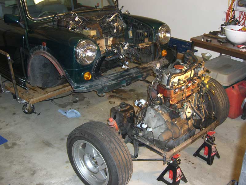

I have had my ERA for a couple of years. Runs good for the most part, but with a little trouble going into second gear. I have just started a rebuild a project and spent a couple of saturday nights getting the engine out.
http://turboera.com/ - I started this site to track my progress.
I am not 100% sure what I am going to do on the rebuild yet, but have been spending a lot of time going through this site and turbo-mini.com. It will likely be a 1293, but we will see. The part I am most uncertain about right now is how I should be upgrading the gear box.
Here is a picture of the engine just after being removed.
