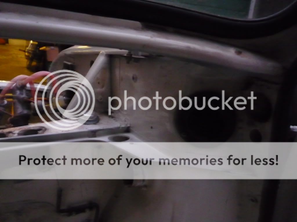

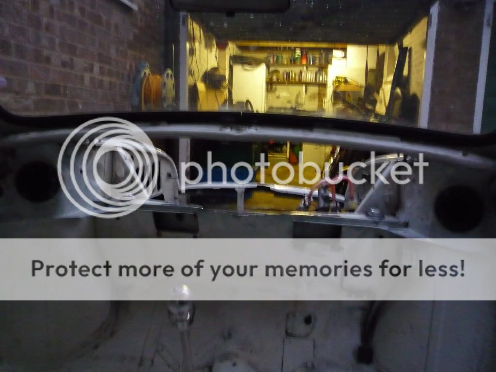

Just thought i put some pic's of my miglia alloy dash build as i havent seen any other thread's on this i will be up dating this build as i go along. Any comments welcome:)

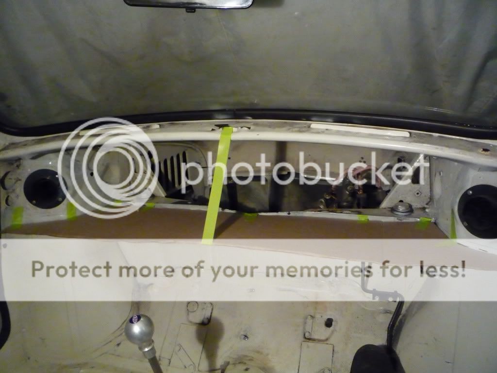

looks great, not sure about the cardboard though

Cardboard is light though!! Will be good to see it come along!

Cardbord is proberly lighter than carbon fibre but wouldnt be the best fire wall!

Paul do you notice the large amount of wiring in my dash. This is why i had to re do it (what a mess)

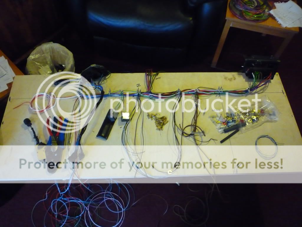

a pic of my new loom. Had to make a new one as i would have had to heavily modify a std one.

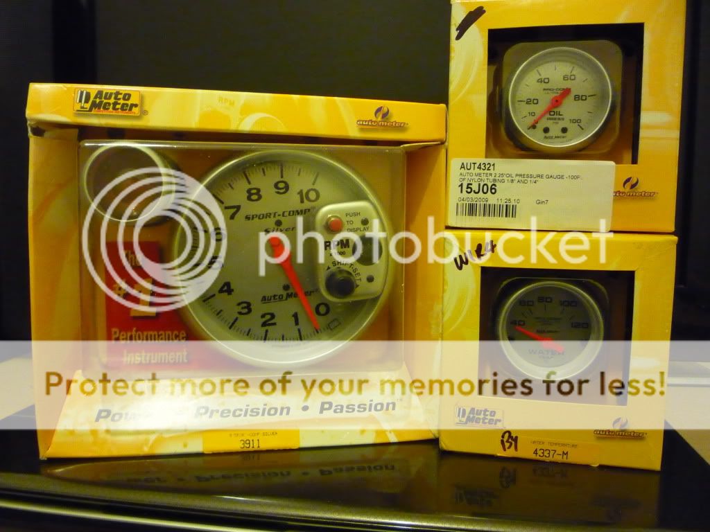

My new clocks arrived today.
i have the sport comp guages there a bit bright at night i have a switch to turn the backlighting off
