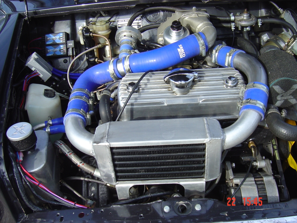

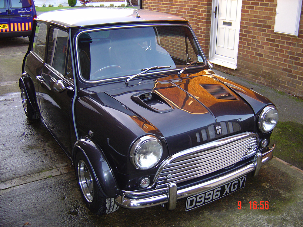

Hi guys, just thought I'd put a few pics on as I've just joined tonight...
I've had my car since 1996, brief spec:-
new shell, was firstly 1312 with a few mods, tiny intercooler(!) and made 116 bhp at the flywheel, cracked cyl head resulted in...
1293, grp a head gasket, forged pistons, phase 2 cam, med u/light, paddle clutch & grey diaphragm, s/c drops & jkd 'box, x-pin diff 2.95 fd (from 3.7, too low for me), now has big fmic going on & polestar ecu too. Hoping for around 180+ this time.

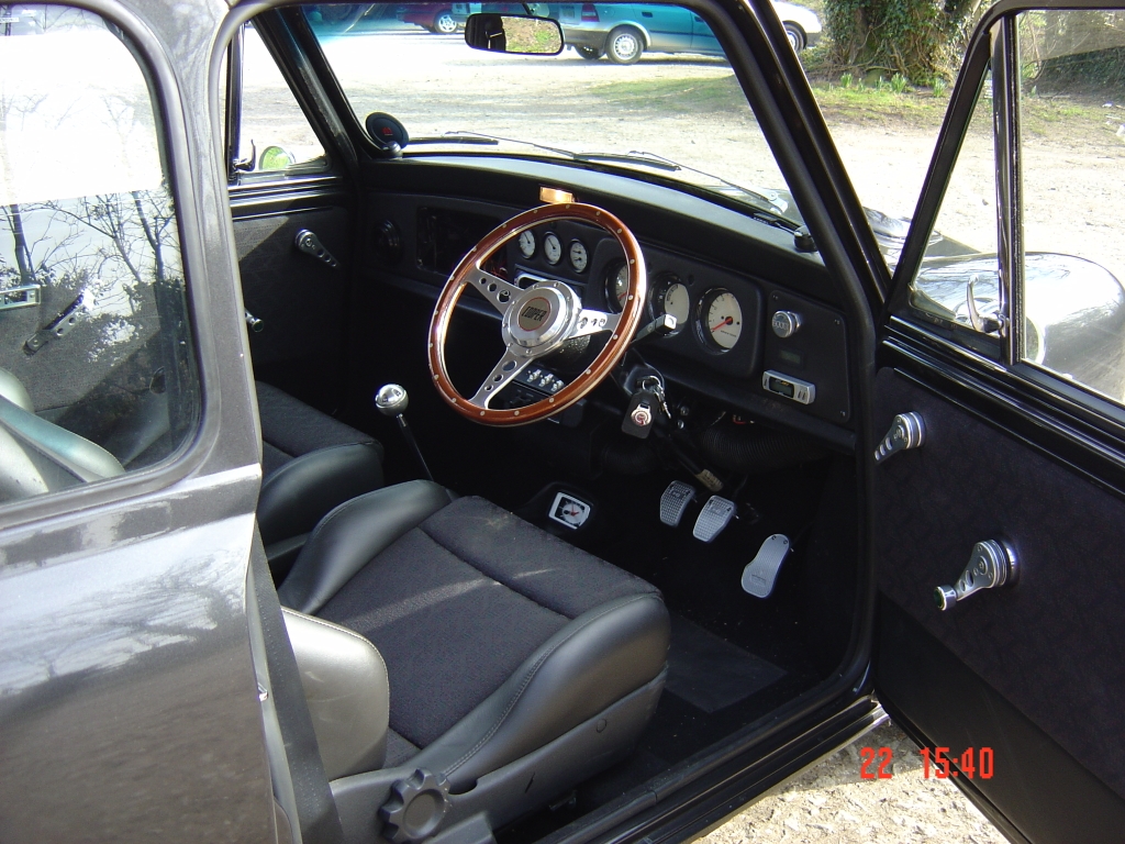

These pics are from 2006 (last time it was on the road), now has centre binnacle dash, minilights (after both front wheels fell apart), full s/d cage, classic buckets and a more old skool look, more up to date pics and spec to follow.

love the colour!!! what IC are you running?

I like that little IC. What is it off or is it home brew?

Hello all, thanks for the comments! The intercooler was made by some guy up near Brands years ago, I had it made just after I started the build after seeing a yellow turbo van in Mini mag i think with a similar one. The one going on now is a big fmic, a bit like Matt Woods one, just sorting the pipes etc at the mo... these things are never quite finished eh?
