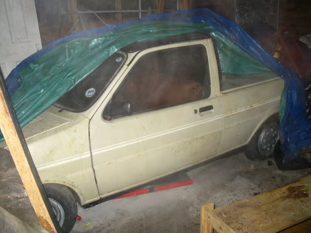

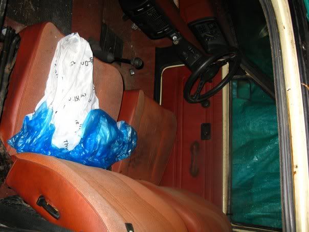

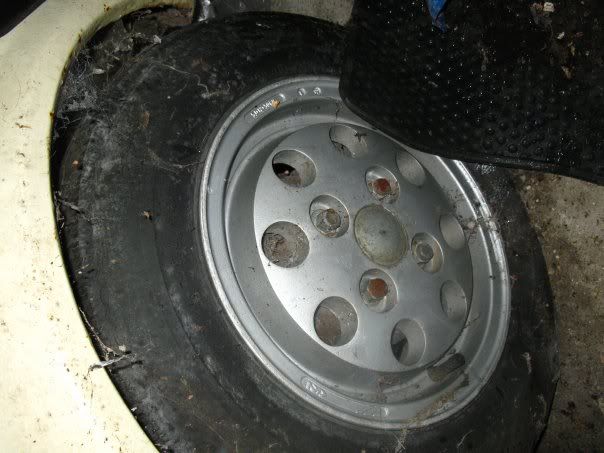

My names Russ and i have found a new project for myself which is an 1980 metro which has been converted in to a two door convertable pick up! It was given to me as a kid and i put it in a barn and forgot about it. During a storm a few months back the roof came in so we had to move stuff out and it was then that i found my old car!!
here are a few pics, it needs a load of work doing to it to put it right but should be fun.
I know this isn't a mini but i found this forum looking for a metro turbo engine.
Going to lower it to the floor and wack a turbo lump in uprade the breaks and not sure after that.
Thanks for looking.8-)

I can't wait to get it up to my place and start to strip it ready for the rebuild.
Ill start a build thread once it arrives and keep you all up to date.
