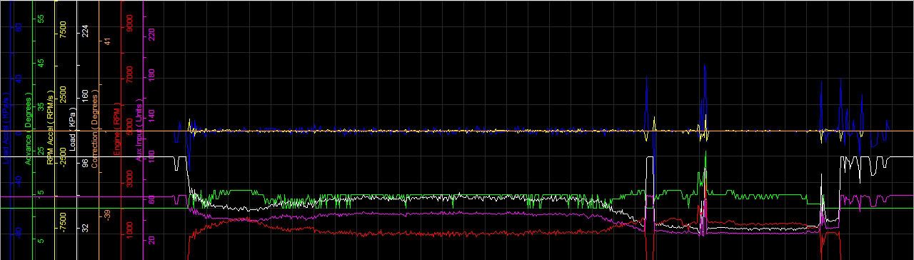

its a touch lumpy and i cant get it to idle less than 1200rpm but i had an almost continuous 12mins running from it this evening so my work here is done and i'll get it booked into a rolling road as soon as i can.

well done mate looking at the info above i would pump a lot more advance off boost around 26 deg will do for now and 22 on boost for safty she will run stacks better than on a bout 12 deg that it shows.
also got your pm but can you pm miniwilliams for rays phone number as i have lost it at the moment
but looks good though mate hope the box will be good for you
