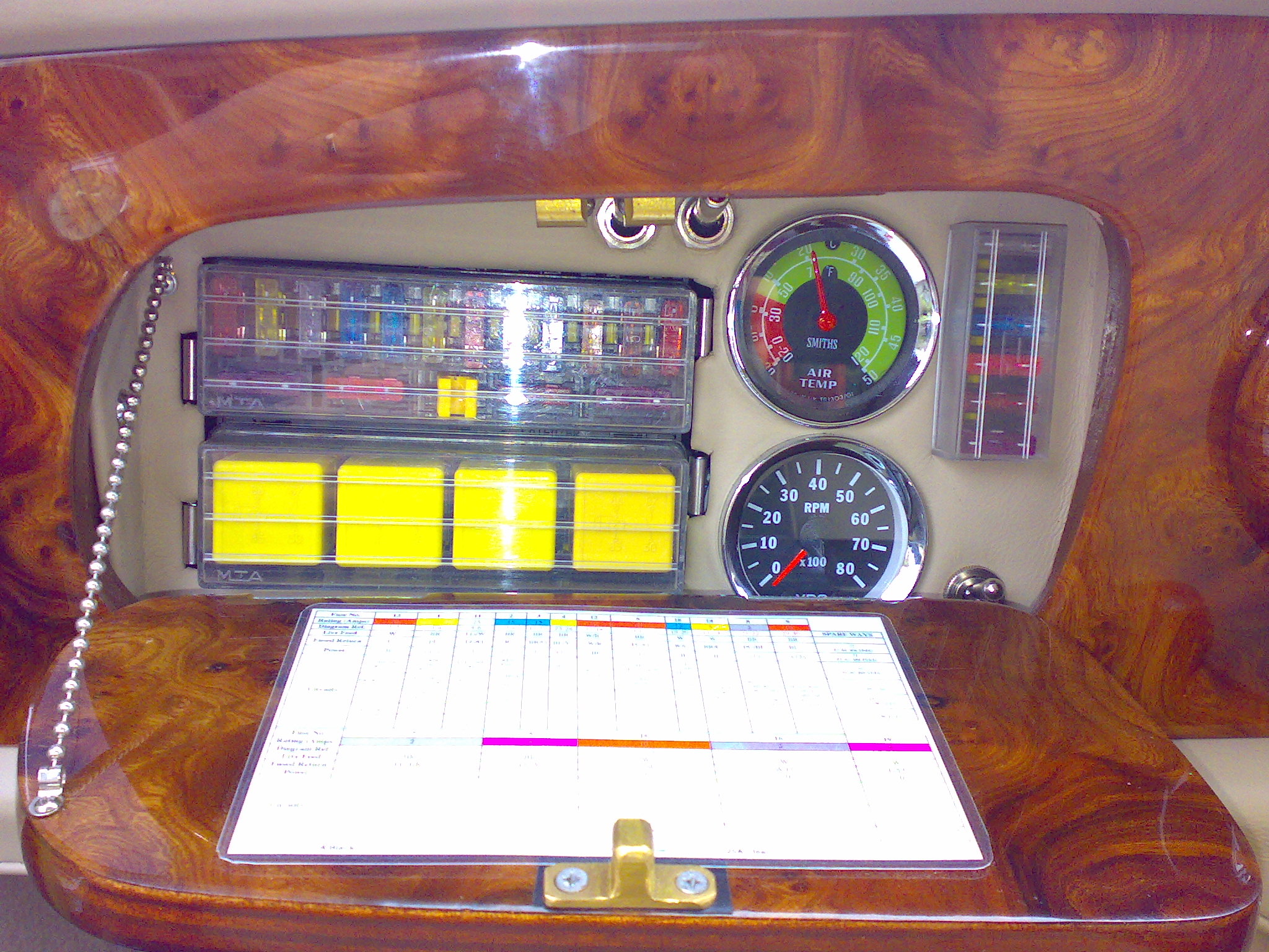

The combined fuse & relay boxes (from Vehicle Wiring Products) are mounted through a hole. The screws and all the bulk of the boxes are at the back and screw to the back of the new glovebox.
This is all made up first and then the dash is mounted as usual (bit tricky). As the dash is pushed into place, the new glovebox mounts via two dome headed socket button allen screws, one either side, into new blocks of wood bonded/screwed to the back of the main dash. The blocks contain captive nuts which the new allen screws easily screw into.
Needs some thought. You are correct, it's a bit tight if you have sausage fingers like me but the whole thing comes together just fine and you can reach the dash mounting wing nuts as long as your hands and arms are made of rubber !
