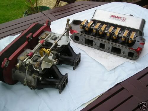

Ill put some manx 7-port pics here too:
but isnt that just still a 5 port??
9326 Posts
No, its a modified 5-port casing, but the inlets are split
oh, i see,where does the turbo go??
lol

Is there a view down the inlet port? :) Looks interesting...

second that be nice to see down the port

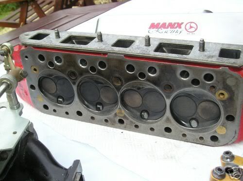

interesting how the divider dosent come all the way to the gasket face?
id have thought it be nice to have it totaly separated into a full 4 ports

Yeah but the manifold face goes into the head, so technically does
I suppose it improves the flow path into the cylinder and greatly reduces the effects of charge robbing, so although at a glance it looks a little pointless you need to look a little deeper

I wonder what is the cross sectionnal area of each splitted port since you still need to deal with the pushrod holes ...
(those valves are massive !)
